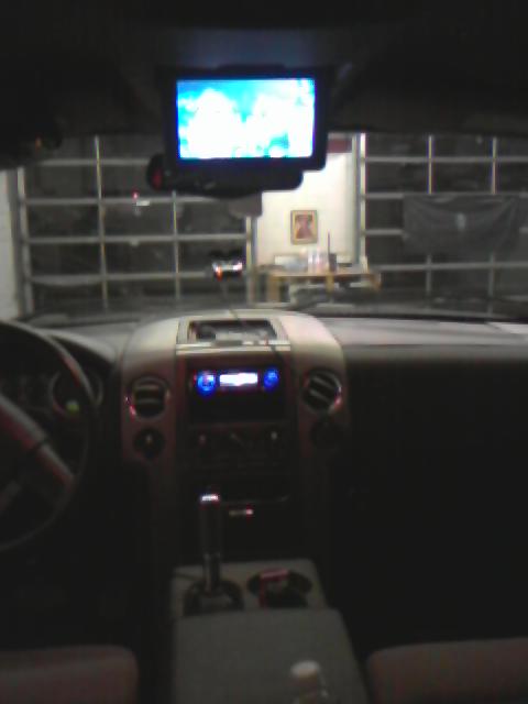

05 ford f-150, audio wires from factory dvd - Last Post -- posted image.
factory headunit hidden behind dash.
Aux plug.
Hardwire to headunit
noisefilter or ground loop isolater might be a good idea
"JT" Advanced Certified installer for Sound Sensations in Marietta,GA
