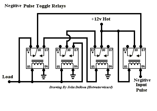

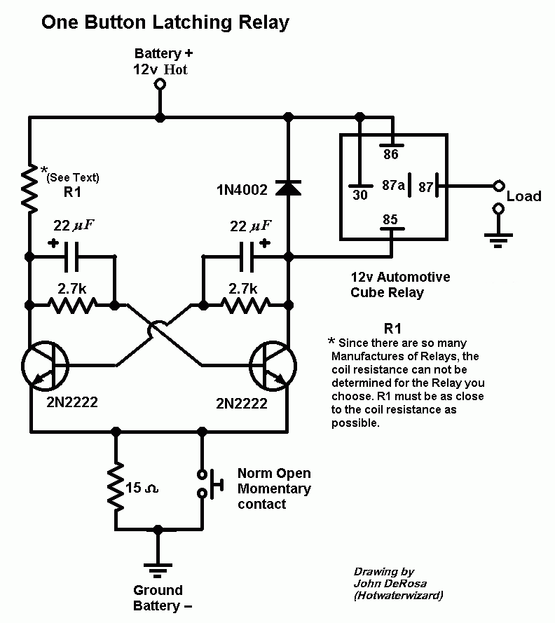

trying to find the ausprotec 0047 module - Last Post -- posted image.

Posted: April 02, 2009 at 10:21 AM / IP Logged
Yeup - I've seen that drawing, and the 5-relay version for when your "load" requires ground current.  It is FAR too time-consuming and - with the price of each relay, connectors, wires - probably far more than $20 for the entire setup.  I'm selling these things in volume and need something quick, cheap and effective.  If I was only building one, this would work.  But that isn't the case.
Thanks though - I think the answer is "stick to what I already had."

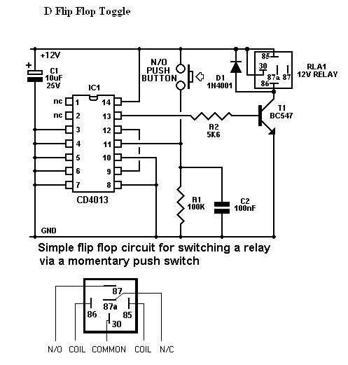

Any experience building electronic circuits?
It should be really simple to use an IC and transistor to do what you're looking for. One pulse to turn on, another pulse to turn off. And with power off, it'd turn off by default.
If by volume you mean thousands, you could get a pc board made up, and the components put on for the assembly. Well under $20.

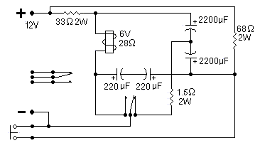

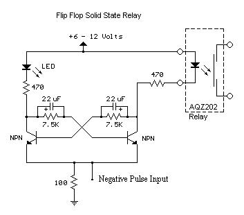

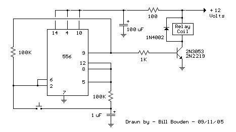

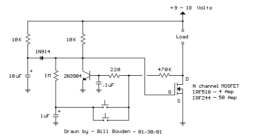

Posted: April 04, 2009 at 9:53 AM / IP Logged
