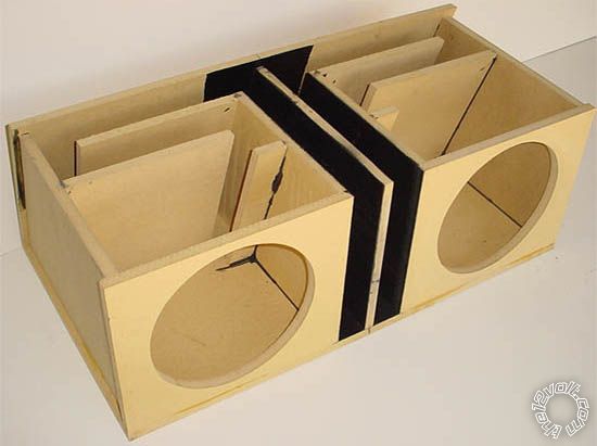

matching enclosure spec's to sub spec's - Last Post -- posted image.
thats a picture of the box im wanting to get. and yes the box will be complete before i get it lol but i've heard boxes with unique designs like that make your subs hit harder compared to a regular ported box.

That IS a regular ported enclosure.  It's just for two subs...

ok, maybe the port itself is regular, but every other ported box you try to buy isnt a maze look like that. its just the basic one piece of wood port. assuming its a slotted port and not rounded ports of course.

There isn't anything wrong with single (basic) ports. It all boils down to the required port length required for the desired tuning frequency. Some boxes look like mazes because they NEED to have the port length to achieve the specified tuning frequency.

The "maze" port is not going to be any better than a "regular" port. A port is a port so the configuration is not going to make much of a difference. The length and cross sectional area are going to be the biggest factors in how well designed a port is. Actually, a port that has a lot of turns can actually decrease performance as there will be energy lost around the turn of the port.
The enclosure you pictured actually looks very similar to Diamond Audio's recommended port design for some of their subs. If that is the case then you would have a very high tuning (around 40Hz) and small internal volume (around 1.25 cubic foot per chamber would be my guess). So that would actually be far from the manufacturer recommended enclosure. I would guess the 2.0 cubic foot volume did not include the port or sub displacement.
Also, is there a slant on the front of the enclosure or the back? If the slant is on the back it would be bad as the port area would change. This would not be a proper port design.
