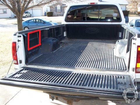

Im looking to try my expand my fiberglass abilities. The project Im looking at doing is building a small box/enclosure/case for the side of the bed of my truck where I will put in a power inverter. Basically what Im thinking of doing is making a small box to mount to the inside of the bed. In here I will mount the power inverter and also waterproof electrical outlets.
I dont know how I can get a fiberglass mold of the backside of the box so it sits flush against the side of the bed. Im read how to cover an area in fiberglass but wont this be hard the area Im making a mold of is vertical? How can I accomplish this? Should I make a template first using Styrofoam and then make the mold from that? What are your recommendations?
Here is a pic of the area Im referring to.
