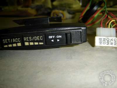

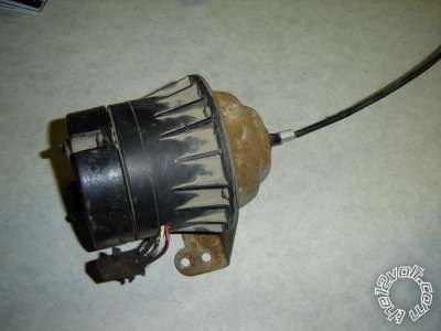

here is the unit:

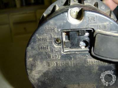

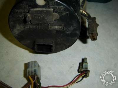

back of the main unit
identify, wiring for this cruise unit - Last Post -- posted image.

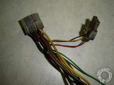

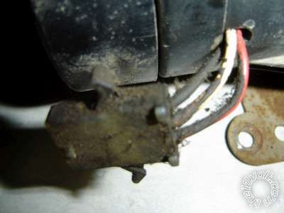

here is where the harness plugs into the main unit
here is the main harness

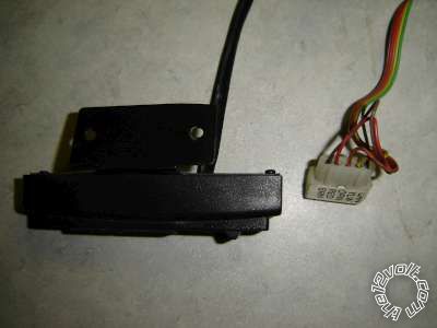

here is the control unit

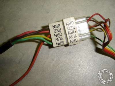

here is where the control harness connects to the rest of the harness

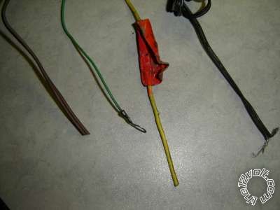

here are all the 7 wires that i assume at least 4 need to be connected.
the yellow one says " noise suppression do not remove" and its got a little something ( a noise suppressor no doubt) shrink wrapped on it. I have no clue where this goes, not sure it was even connected to anything in the civic.
The BROWN one on the far left is actually two wires one with a white dotted line on it, it was going into the the firewall and was connected to part of the harness below the steering column.
the BLACK one on the far right is also two wires, one with a dotted line, I think it was going to the speed sensor, it went down to the auto-transmission of the civic. The GREEN one was connected to ground when took it off the civic. not sure why there were two wires going to the speed sensor.

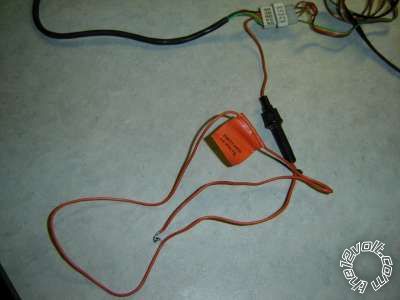

this orange one says "switched 12 volt" on it, im assuming this goes to the hot side of the brake If my mazda has that...

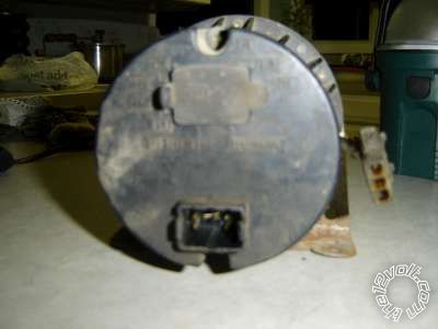

and here are the option/switches available on the back
so what im hoping to find out is, where each wire goes, and which settings to use regarding the speed sensor and the sensitivity. i know to set the cyl. setting to 3or4 not 5or6.

That looks like it could be an old Zemco cruise control unit. I would say throw it away and make it go as far away as possible. Those units were the worst thing I ever had the agony of trying to install. The unit is probably about 20 years old. The quality control was non-existant. Almost every install wouldn't work because of bad parts. It took numerous parts to make one working unit. They never lasted more than a year at best. Take it from someone who has done thousand of cruise controls. Run away and run fast. You can buy a new unit and install it without a lot of fuss and cost.

thanks to sparkies ID of the unit ( Zemco )  i found a manual for a DIFFERENT unit and this is what i found out, for those of you who care.
the brown wires are for the brake switch and the polarity is not important
the black wire is for THEIR OWN speed sensor, it was connected to axle strap sensor, i assume. though i never saw this when delicately removing it....
from this i can assume that the yellow wire connects to the coil and that is why there is a noise suppressor
and the orange is the power for the unit, and the green is of course still ground
so now im wondering if i can hook this up without using the speed sensor, sorry sparkie i might ignore your advice for now.
