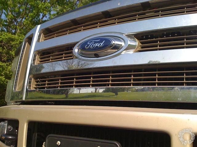

Here is a shot of the camera mounted on the front of my truck.
How To Flip Video Image - Last Post -- posted image.
