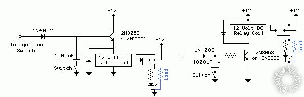

FYI - from my DELETED reply (with apologies) to the simple way to make a time delay relay thread....
It's merely from a quick search, and for relays, but substitute LEDs instead...
From Electronics Today - Circuits Cookbook #5, page 84:
l.e.d and a cap - Last Post -- posted image.

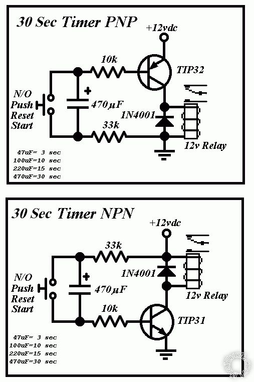

And from (or based on) Bill Bowden:
(PS...)

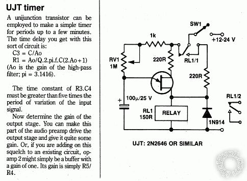

And from an unknown source:
