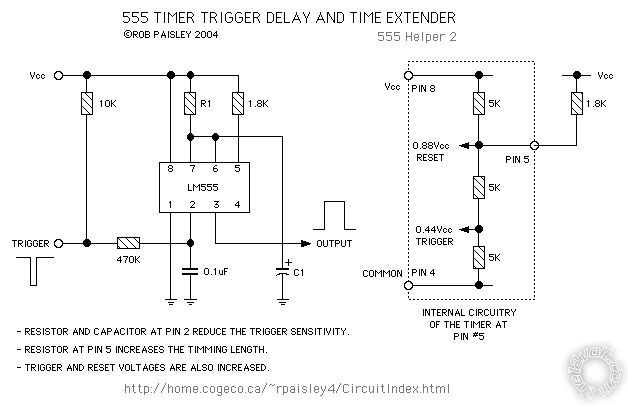

Has anyone here hobbied with a PIR? Since the contacts will be open\closed for a short amount of time, this might be a simple 555 timer I can mod the circuit?
Any other idears how to get a 90 second delay with a 12v motion detector?

A simple RC-FET circuit should do, but otherwise maybe some overkill with a 555 (and its load of 10mA)...
