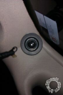

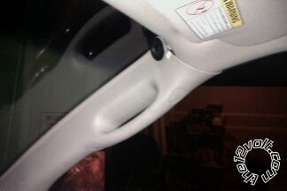

So i have a 3 way front stage , fully active crossover and eq set up. My midrange and tweeters are mounted in the kick panels and my mid bass are in the doors. ( i can list all equipment if needed but i dont think it is relevant for this discussion). With my frontstage speakers in these current mounting locations my system sounded good but lacked stage height , depth , width and to me there wasnt enough detail in the music.The music sounded like it was at about chest high at best ,and the width was very narrow wich made the music kind of in your face and harsh sometimes.
I described the above problems on another forum and got some good responses like "adjust your crossover points" or "play with your time aligment" , These worked ok but not that much improvement.Then someone suggested to add an extra set of tweeters up high on the dash or on the apillars and use an inline cap to play them from 10khz and up.
So i found a set of tweeters for $7.00!! Dayton ND20's to be exact. I tried this method with an inline cap @10khz as recommended and in after about five minutes of tuning my system sound fantastic!!! My stage height is now at at least eye level,the width now sounds to be coming from outside the apillars and the depth of the music is beyond the glass. Much more detail and sparkle in my upper end frequency. It is incredible how much of a difference this has made. If you have any of these same issues i would highly recommend this.
Here is some pics to show how i mounted them. There run of the rear ch. of my h/u with about 22 watts rms going to them .
how to raise your soundstage - Last Post -- posted image.

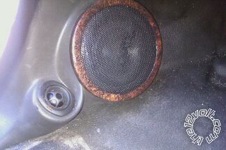

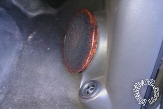

pics of my kickshow to raise your soundstage - Last Post -- posted image.
how to raise your soundstage - Last Post -- posted image.how to raise your soundstage - Last Post -- posted image.
