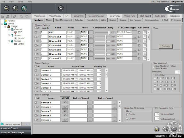

I need some help with wiring up a relay. I would simply like the relay to turn on a 12v LED. I have an i3 International (i3DVR) for my surveillance. The DVR actually can control the output from the software, just need to know where the wires go on the Altronix RB1224 Relay.
relay for dvr cctv - Last Post -- posted image.

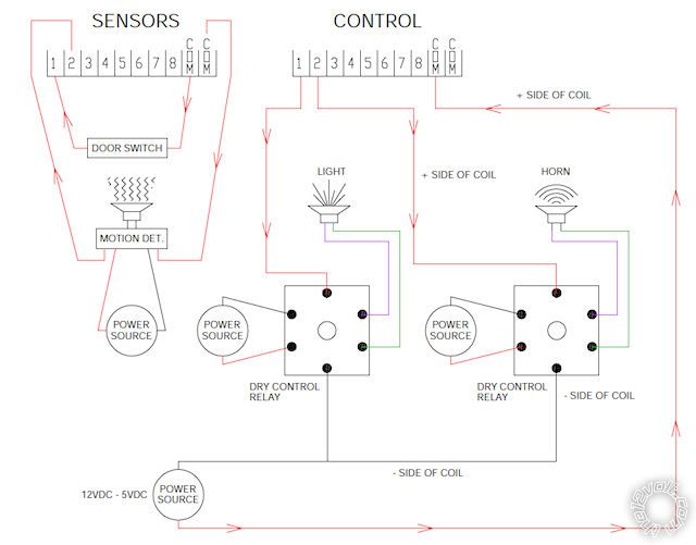

Here is an old document I found that may help out:

There is 8 connectors on the relay, not sure what goes where.

Figured it out.
