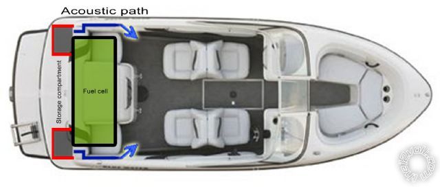

For example: I built a box for a boat recently that was located in the rear storage compartment. The subwoofer fired down at the floor. I built a frame around three sides of the bottom of the box (indicated by red) so that all sound was forced out one side of the box. This side of the box was partially obstructed by the fuel cell of the boat (green). The end result was a very small chamber beneath the box that the sub fired into (2" high X 14" X 11") and a long odd shaped path that led into the listening area. I purposely blocked off any acoustic path to the storage compartment.
subwoofer loading: avoiding the band pass - Last Post -- posted image.
I whipped up a band pass design in Bass Box that had a sealed chamber equivalent to the volume of my sub box and a front chamber equivalent to the volume of the space between the sub box and the floor. I then calculated the average cross sectional area of the path between the box and the listing area as well as the length, and plugged those numbers into my design as if they where port dimensions. Now Bass Box can graph the velocity and resonant characteristics of the entire path!
This design on the surface looked sketchy, but I knew that I would get the result I was looking for because I did my homework. This Box had an Fb of 41Hz and an F3 of 32Hz in the boat. I was able to confirm this after the fact by running an impedance sweep.
