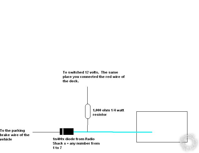

Platinum - Posts: 13,725
Posted: January 08, 2012 at 5:56 PM / IP Logged
park brake interlock - Last Post -- posted image.

leighhoey
Posted: January 08, 2012 at 6:21 PM / IP Logged
Diagram greatly appreciated and I think I can handle that mission. It'll be next weekend before I see the car again to try this but I'll be sure to let you know if it works. Thanks for the help!
