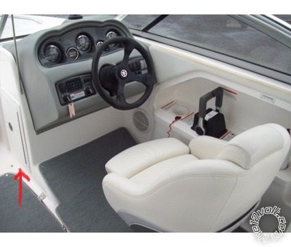

Here is a picture of the area I'm asking about. The red arrow is the door opening that I'm trying to get this box into. Under the dash area is pretty open and spacious behind that little door.
ported box for boat and size restraints - Last Post -- posted image.

How deep is the woofer?  If your enclosure is 9.5" deep and 17.5" tall, if you can make it 26" wide, using 3/4" marine plywood you'll end up with 1.8 cuft gross volume.  Add the driver and a couple simple cross braces and you're right at 1.7 cuft.  But will your woofer fit into something that's only 9.5" deep with 3/4" walls?

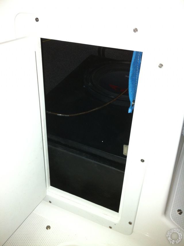

Well, I finished building it. He's amazed at how it sounds. Here's a couple of pics of it. It was a super tight fit in the boat, but it fit.

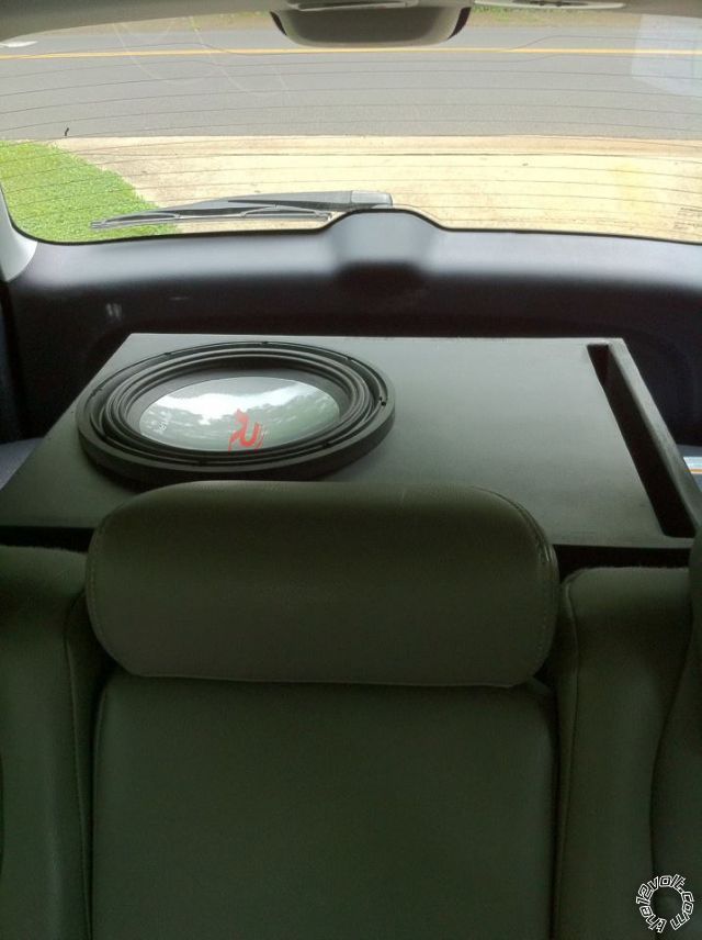

Posted: May 14, 2012 at 5:01 PM / IP Logged
Here's a pic of it in the boat. Sorry for the crappy quality.
