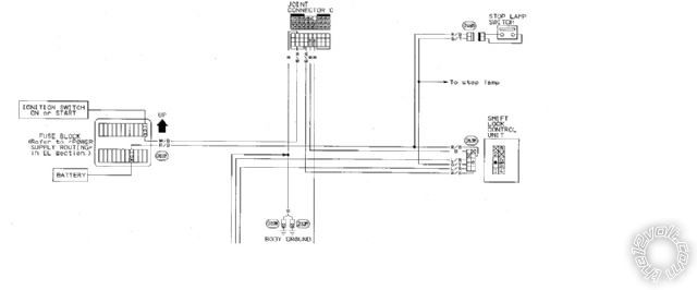

I am an idiot: the following is a part of the wiring diagram that leads me to believe that the shift lock control and that same fuse that controls the dash warning lights are connected in some way-perhaps by the neutral safety switch? The 10A fuse, shown on the diagram at the top right of the fuse box, is the one that controls the warning lights and gauges. Please advise.

Posted: September 30, 2012 at 4:43 PM / IP Logged
Test at the starter solenoid, as I said before, someone turns the key to start whilst someone else test it.
It should go to 12v+ when the starter is cranked.
My guess would be the inhibitor switch or relay.
