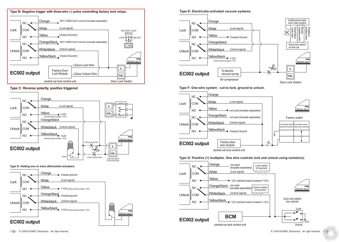

3. The door unlock/lock wires I have some questions about. I believe I need to follow "Type B: Negative trigger..." wire diagram but could be wrong. Can I hook up my alarm negative lock trigger wire directly to the car brown/orange lock wire? I would ask the same of the unlock trigger wire but it appears there are two locations for unlocking the car. The yellow/black wire will only unlock the passenger doors and white wire will only unlock the drivers door? I really just want all doors to unlock at once but I believe I need to split the unlock wire? I am not sure if I need to follow tech tip 1300 as I am not sure if I actually have an oem alarm which I do not need anymore.

If anyone understands the door lock wiring information better than myself, some advice would be much appreciated.

Well most everything works. So far I only found two issues so far....
One - I wired the alarm blinker/parking light wires and split them to all four of the turn signal wires listed. Everything on the alarm side works properly but when I use the actual blinker (L or R) in the car, the entire vehicle acts like the hazard lights are on. So I guess I'm going to try the (+) parking light wires instead. The (-) hazard wire might be an option but it looks like that is a negative output instead of the required positive per the alarm.
Two - my door locks worked by direct wiring the car alarm. After some hours I went back to the car and unlocked the doors with my alarm key fob and the factory alarm is working! I did not arm the car before with the factory key fob or factory key but it definitely enabled itself. If anyone could help me understand the tech tip 1300 diagram or the best way to wire switch (diode size?) with the factory wires to disable the factory alarm, I would be very grateful. I currently have the dome supervision wire of the alarm wired to the dome supervision wire of the car so I believe that would need to be disconnected and reinstalled per the tech tip?
Power Lock BROWN / orange - dash fuse box, rear, white 32 pin plug (E), pin 5 ~{Currently direct wired to alarm}~
Power Unlock yellow/black (passenger doors) - dash fuse box, rear, white 32 pin plug (E), pin 6 ~{Currently direct wired to alarm}~
Notes: To unlock the driver door, you can 5 wire the driver unlock motor or use white (-) at the relay box behind the glove box, white 24 pin plug, pin 21. ~{Currently direct wired to alarm}~
Factory Alarm Arm brn/blk (key lock); RED / og (detect)(Tech Doc 1300) - and open power window main switch, white 32 pin plug, pins 22, 24
Factory Alarm Disarm pink/blk (key unlock); RED / org(lock/unlock detect) both - power window main switch, white 32 pin plug, pins 23, 24
