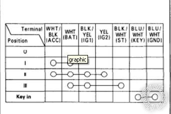

The start wire is blk/wht (the one that should be charged when the key is turned all the way to start)
but I also have the same low voltage when just in the ON position
So do I relay the blk/wht wire or the blk/yel wire which is the one that should be hot in the ON position, since that is where it returns after starting

Platinum - Posts: 13,725
Posted: May 17, 2013 at 1:55 AM / IP Logged
Ignition is BLACK / YELLOW.
