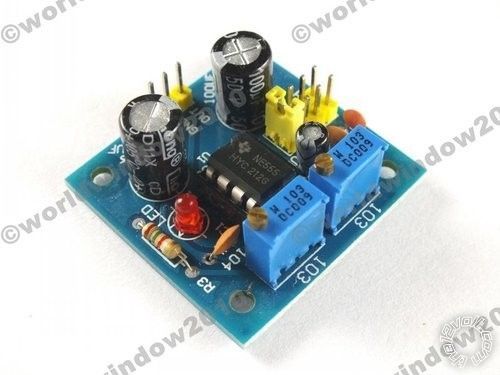

eBay links are not accepted, but all you need supply is the item number so I now have the US $3.49 NE555 pulse frequency adjustable module Square/square wave signal generator.
That has two big caps and I'd assume one is for power smoothing since it uses 3 selectable caps depending on frequency range (big, medium & small).
I note it specifies a mere 15mA or 35mA output etc - so what about the 555's normal 200mA output (at 12V)? (ok, maybe 20mA of that goes to the LED.)
But the spec is unclear - why say output is "≥ 35mA (12V power supply)" when it should give a max output capability (eg, 150mA or 150mA)?
Inability to supply the load could cause problems. Normally it'd blow the 555 (if above the 555 spec) but since this is a lower output spec current, is its supply limited somehow, or output buffered?
I need to see the module's circuit...

Nah - I got the eBay link - ie, after "itm" in the site-censored link is the item number so I could go to eBay & search. Hence why I gave the eBay "title" above.
It's pic is:
led flasher - Page 2 - Last Post -- posted image.
And now I see your diagram on page 1 (I didn't see that before).
But that is different to what I described.
But I note that the RainLight spec claims 250mA which is too much for a 555, and maybe too much for that 555 module (if it's 35mA etc).
Note that the RainLight claims 130mA @ 13.5V = 1.8W (flashing) but that will be an average figure and it is still a 250mA load (ie, 130mA/250mA suggests a 50% on-off flashing duty cycle).

Anyhow, you 555 module will not handle the CK-LR-15 or others since the 555 is 200mA limited and there is no buffering (amplifying) transistor on that module.
You need to add a transistor or MOSFET to handle the 250mA, and that should be on the +12V side to simplify the circuit.
