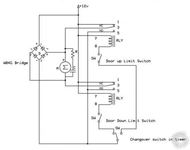

And FWIW, instructables How to wire a 12v motor and limit switches to... has the following diagram noting that its car ignition control (via the Changeover switch in timer) may not suit your application.
power window motor with relay - Last Post -- posted image.

Thanks for all of the good info. I tried to wire it up from your 2nd to the bottom diagram and had no luck. I was using a DTDP switch. I then just hooked up the circuit without the relays and got the motor to to turn both directions. What if I just went without the relays and just used the switch, motor and limit switches? What do the relays do that would benefit the circuit I am trying to do? Also, when I use the two limit switches, when the boom reaches its destination and the limit switch is activated turning off the circuit, when I turn the motor to go the other direction wouldn't the circuit not work because the limit switch is still in the off position? How could it be wired where if I use a toggle switch that has no off position (either going in one direction or the other) and use 2 limit switches where I turn the toggle switch one direction activating the boom, limit switch turns off motor, then the toggle switch is turned in the other direction turning the motor the other direction. Thanks again for all of your help.
