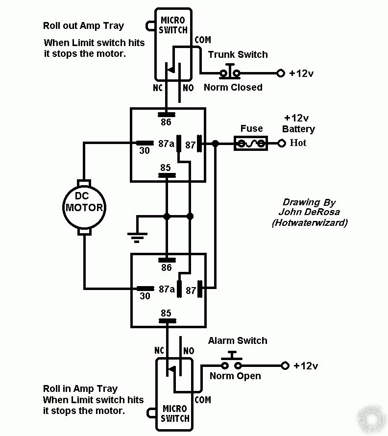

I would like to wire relays with positive output until it hits limit switch then when the power is disconnected it switches polarity

Posted: April 03, 2015 at 9:56 PM / IP Logged Link to Post Post Reply Quote hotwaterwizard
Here is a circuit I came up with Years ago,
How to wire relays - Last Post -- posted image.

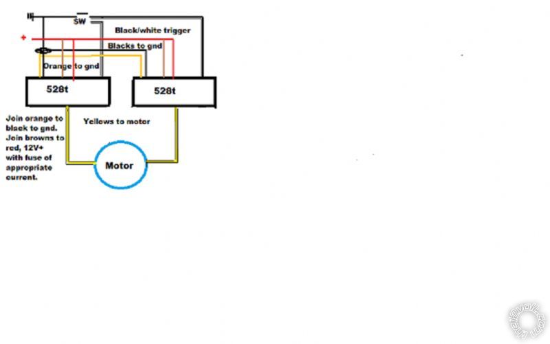

I basically want a motor to open and close a chicken door on a timer with a 12 volt setup
Posted: April 04, 2015 at 12:17 PM / IP Logged Link to Post Post Reply Quote howie ll
Use the above circuit or use 2 ready made timers from DEI, 528t:-
The switch is an SPCO, or momentary centre off, this will give you one touch open and close.

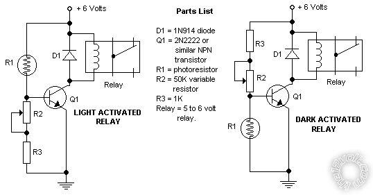

Posted: April 04, 2015 at 7:00 PM / IP Logged Link to Post Post Reply Quote hotwaterwizard
You could also do a light senitive one that would open the door in the morning and close it at night.
