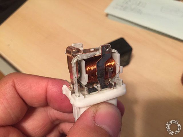

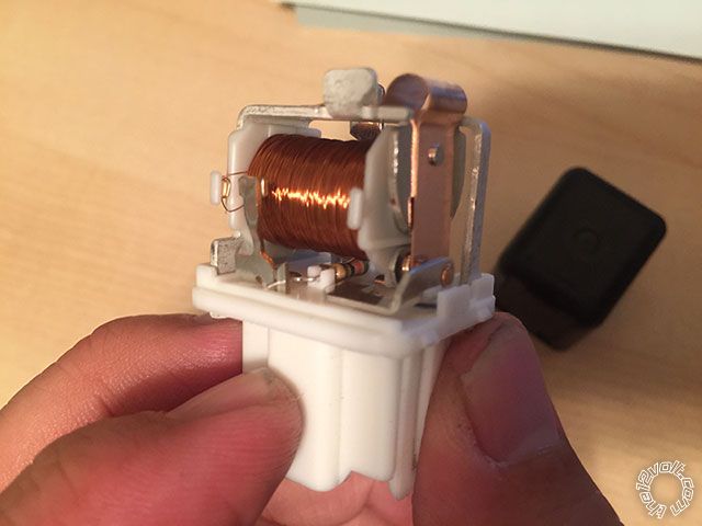

I got Toyota Corolla 1999 headlamp dimmer relay 85926-30020.
Toyota Dimmer Relay usage - Last Post -- posted image.
I don't know what the difference comparing with other regular SPDT relay.
Can I use this as same as other SPDT relay?
Thanks!

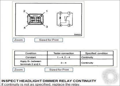

Yes but it's a 4 terminal doing a 5 terminal SPDT job, be careful how you wire it.

Not in all applications. Remove the Resistor and install a Jumper instead and it will switch from #1 to #3 when power is applied to the #4 terminal
#4 becomes #30 and #86
#2 is 85
#3 iS 87
#1 is #87a

Perfect for a latching relay application.
