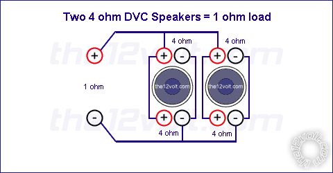

Pretty much as the title says, I guess. Forgive me if there is a topic on it that I didn't see in my research. After hours of Google and Youtube (not all at one time...I do have a job) I couldn't find a singular topic thread anywhere.
What I wish to accomplish is effectively wire (if possible) two 4ohm DVCs parallel for a final 1ohm load, and run that to my Hifonics mono amp.
This is the exact amplifier that I have, and this is the subwoofer I'm thinking about running. Well, two, to be exact.
I just want to make sure the setup is good, and will stable. Last thing I want is to cook the amp, which is why I decided against two 2ohm DVCs parallel at 0.5ohm.
Also, how would the power distribution run? Being 2600w @ 1ohm, would it give 1300x2?

Two 4ohm DVC to 1ohm mono - Last Post -- posted image.
Here is the diagram for your install.
As far as the "power distribution", each woofer will receive 1300W. The amp will see a 1ohm load and give you 2600W.
Now on these amplifiers you will notice the output terminals read |+|+|-|-|. don't be confused they are the same output(mono).
