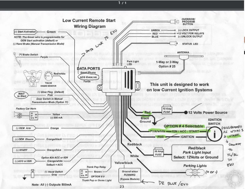

Hi All,
I wonder if someone can give me a hand here before winter hits the ground. I installed a Crimestopper LC1 and Evo all by fortin in our Mitsubishi Outlander 2014 (PTS). I followed the wiring diagram but it seems i have no luck in this. You can hear that the remote is trying to engage but not even a crank and gives me a "electrical maintenance require" in my dash. So I decided to activate the Pink/White for "Start". Engine will crank but it wont start (same error shows in my dash). I'm not so worry about the error as I know that is probably from the remote itself.
Engine Crank, but won't start - Last Post -- posted image.
Can you guys check the wiring if I miss anything?
Also if anyone knows how to clear my "engine light indicator"?
Thanks

I would start here. http://fortin.ca/en/vehicles/mitsubishi/outlander/2015-push-to-start/troubleshooting.html
After that if you have any issues post back and we can go from there.

As for the original question, I'm guessing wiring connections ignition, bypass or tach learning.

Found the problem--- R/S was set to Idata link interface..
Swap cable and connector--- all good
