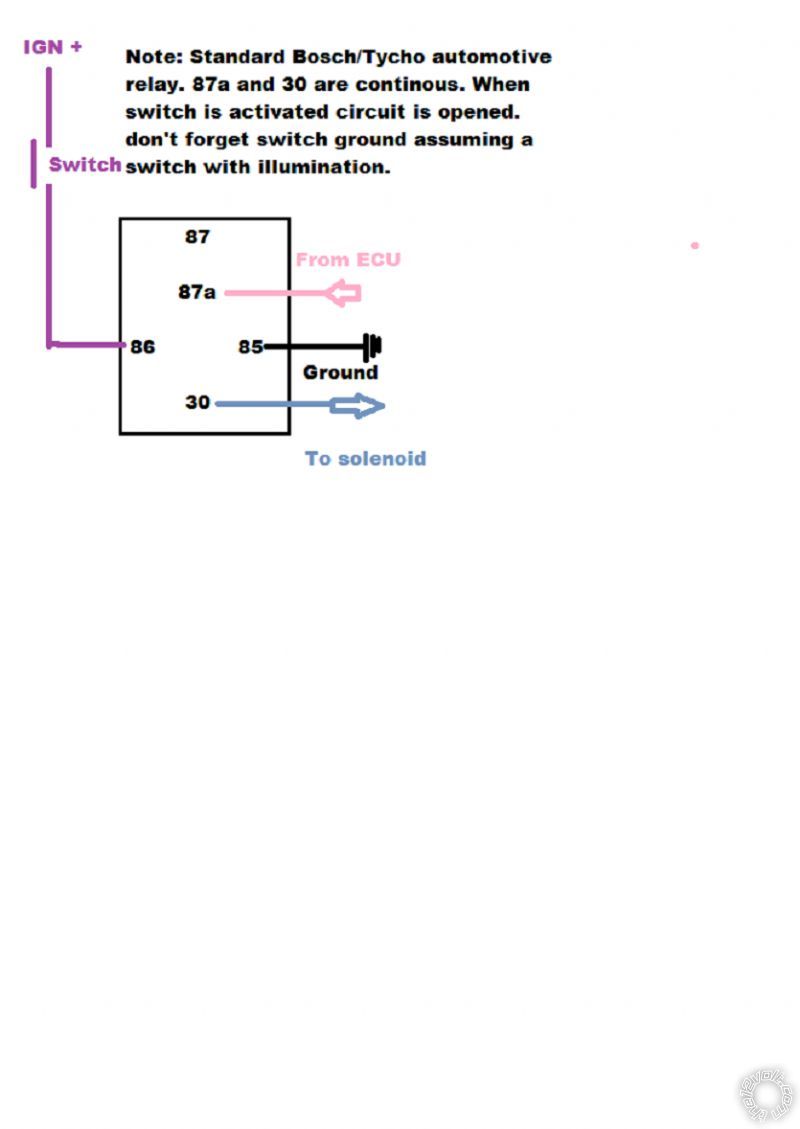

I have a 2004 F350 with a 6.0 Powerstroke and I have a problem with my truck sounding like a jet engine in the morning when its warming up because of the turbo.   I want to using a Carling Rocker Switch to turn the VGT Solenoid off in the mornings so its not so loud.   Now this is a signal coming from the ECU to the Solenoid. I want to be able to use the switch and have the on light turn on when the VGT Solenoid is off.   Is this something that's easy to do? I am sure I wold need a relay of some sort to get it done just not sure what i would need or how to wire it.

This is your circuit:- power_cut_relay.png

Awesome thank you so much for the help and the quick reply! I will be giving this a shot in the near future..
