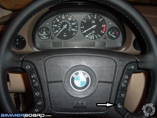

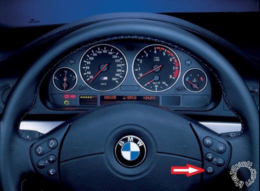

Hi folks,
I am trying to add heating functionality to my stock "sport" BMW steering wheel. Other BMW steering wheels have the heat option, just not mine. So what I did was bought a used heated BMW wheel and stripped out the heating element. Now I need your help in creating a switch to activate the heat. The car is an e39 BMW 5 series.
BMW uses a multi-button "pod" that mounts to the steering wheel and that has buttons for steering wheel heat, radio volume, etc. See the first pic. I bought one of those pods hoping to transfer the button for heat to the wheel I want to add the heating element to (see second pic). The problem is the "pod" is way more complex than I imagined with what seems like a bunch of momentary switches connected to a circuit board.
Can you teach a newbie like me to create the proper switch to add to the heated wheel in the second pic? I'd like to repurpose the "R/T" button, or gut it and put the proper switch under it, to make it operate the heat. What information do you need from me? I already have the correct clock spring and circuit board for the heating element. Now I just need a button to operate it like the factory button does (first pic).

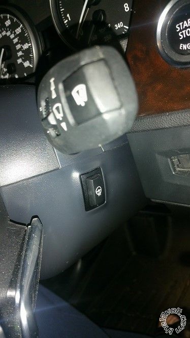

Get one from an e90. They mount right on the column

Switch for heated steering wheel - Last Post -- posted image.
