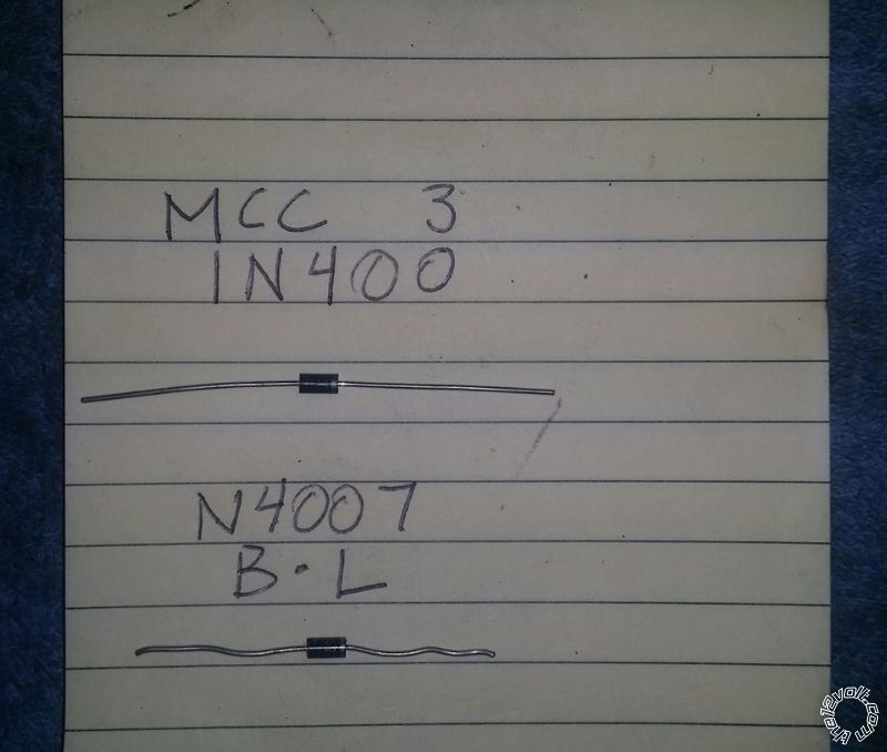

I have 2 diodes on hand and would prefer to use one of them if one will work, however I don't know what the markings tell me. Here's a picture of them with what is written on each of them.

Posted: January 31, 2016 at 5:24 AM / IP Logged Link to Post Post Reply Quote geepherder
Either one should be fine. If your meter has a diode test, touch your negative probe to the side with a stripe. The other side goes to positive. You should get a reading/audible tone. Reverse the leads and you should get no reading/tone (it may say OL).
If your meter doesn't have a setting for this, you may be able to take a resistance reading. Again, stripe to negative, other to positive, you should get something. The other direction, you shouldn't.
