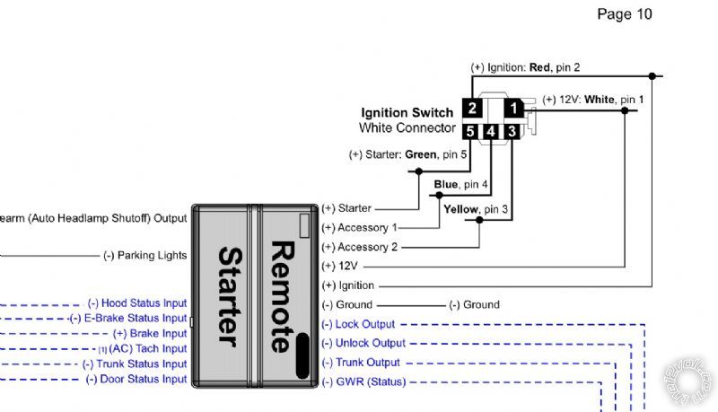

I am preparing to install this system into my 2014 CRV and I am just wanting to make sure I properly understand the accessory wiring. I am just not sure which wires to connect from the viper 10 pin to the vehicle. The install sheet shows accessory 1 and 2 need to be connected. (See pic)

Posted: February 01, 2016 at 7:24 PM / IP Logged Link to Post Post Reply Quote kreg357
Remote Start, 10-pin heavy gauge connector
1 NC No Connection
2 RED / BLACK (+) FUSED 12V ACC/STARTER INPUT White
3 PINK/BLACK (+) FLEX RELAY INPUT 87A  FLEX RELAY    not used
4 PINK/WHITE (+) IGNITION 2 / FLEX RELAY OUTPUT          Yellow    *** Viper Menu 3, Item 8, Opt 2
5 RED (+) FUSED 12V IGNITION 1 INPUT      White
6 GREEN (+) STARTER INPUT (KEY SIDE)    Green
7 VIOLET (+) STARTER OUTPUT (CAR SIDE) Green
8 ORANGE (+) ACCESSORY OUTPUT           Blue
9 RED / WHITE (+) FUSED FLEX RELAY INPUT 87      White
10 PINK (+) IGNITION 1 INPUT/OUTPUT        Red

Posted: February 01, 2016 at 7:55 PM / IP Logged Link to Post Post Reply Quote kreg357
The Viper has a thick Orange wire ( H3/8 ) that will be connected to the vehicles Accessory 1 wire ( Blue @ Pin 4 )
The Viper has a Flex ignition output wire ( H3/ 4 Pink/White ) that you will program to Accessory 2 and connect to the
CR-V's Yellow Accessory 2 wire ( Pin 3 ).
It really doesn't matter if you reverse them ( Pink/White to Blue and Orange to Yellow ).  It will accomplish the same thing.
Viper Remote Start, 10-pin heavy gauge connector 2014 Honda CR-V main IGN connector

Posted: February 01, 2016 at 10:19 PM / IP Logged Link to Post Post Reply Quote bt311
*flips brain on*
Now I get it! How embarrassing haha! Thank you kindly for your replies!
