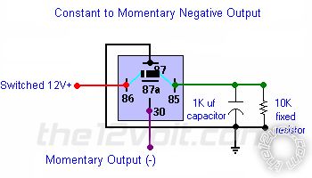

Using this diagram:Momentary Output Pulse - Last Post -- posted image.
How would I extend the pulse to 5 seconds instead of 1/2 second? Multiply the capacitance of the polarized cap by 10 which would equal 10k uF?
I searched the internet for 2 hours and couldnt find a simple circuit to do what I want so I was hoping someone here could help me out. Thanks in advance.

I've used a 528t before and it would work but I would like to add some more knowledge to my bag of tricks by using a relay, cap, & resistor and understanding how that circuit works.

This diagram gets posted on his website and no one knows how the cap/resistor values are calculated and how that relates to delay in seconds?

Read here for more info: http://www.electronics-tutorials.ws/rc/rc_2.html
The delay will depend upon the coil resistance, drop out voltage of relay, capacitance value, parallel resistor value.

Excellent! Thank you for the info and direction. I really appreciate it.

For a few seconds:
http://www.diymobileaudio.com/forum/how-articles-provided-our-members/2727-designing-your-own-delay-circuit.html
For a few minutes:
https://www.youtube.com/watch?v=GeveeSTyvGs
