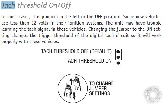

Hi everyone,
I'm having an issue setting up my Viper 5706v (installed in a 1995 chevy 1500) to use tachometer mode for engine checking. I hooked up the violet/white wire to the white tach wire from the ECM, behind the glove box, which showed fluctuating AC voltage with engine rev and performed the tach learning procedure after install. The truck starts perfect when it has been ran within the last 10 or 12 hours. However, if I leave it sit overnight and use remote start, it only cranks about 1.5 seconds and disengages the starter before the engine fires up... it cranks again and fires up fine (the truck has always needed a little extra cranking after sitting). At this point, I changed the cranking time to 4 seconds but it still only cranks for about 1.5 seconds on the first attempt. To test that the tachometer feature was working, I unplugged the main wire feeding the distributor (so the engine wouldn't fire) and tried remote starting. The starter still only cranks for 1.5 seconds and repeats for 3 attempts before giving a "failed to start" error code. I've also tried revving the truck up to about 1200 rpm and learning the tach signal but I still get the same behavior. Can anyone tell me what I may be doing wrong or steps I may have missed? I have a full install manual for a 5701 model and it has a "Tach threshold on/off" jumper but it sounds like that is only for the voltage or virtual tach settings of engine checking.??? I also know that my "old" truck has a STRONG 12v ignition system output.
To get the vehicle to start on the first attempt after sitting, I programmed it for virtual tach and left the crank time at 4 seconds which works flawlessly but I'm still baffled as to why I can't get tach mode to work right..... Thanks in advance for advice!Viper 5706 Tach mode crank time - Last Post -- posted image.

Thanks for the replies everyone. There are two reasons that this behavior bothers me: 1) Extra wear on the starter and flywheel teeth. 2) My personal irritation that I can't get something to work the way it's supposed to. GRRRR!!
One thought that crossed my mind (most likely impossible) is that maybe the starter is cranking the engine over fast enough to generate high enough AC voltage to meet the threshold and disengage the starter. I dunno...
Mark Mizenko, I really don't know what the difference of AC voltage output would be between the tach wire at the ECM versus the injector wire.... Could you explain why it would be better? I'll take a shot in the dark here but is it because the injector won't actually fire unless the computer sees enough fuel pressure??? If that's the case, I could see how that would make a difference.
