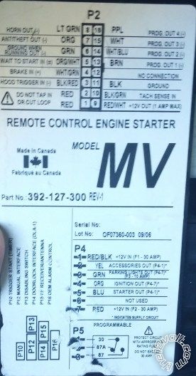

Trying to program another remote to a Astrostart 392-127-300.
Astrostart 392-127-300 - Last Post -- posted image.
It does NOT have a hoodpin. So I tried the guide in this thread: https://www.the12volt.com/installbay/forum_posts.asp?tid=110314
No luck.
How do I program another remote? It's a JSF-TX903

This is installed in a 2006 Toyota Tundra Crew SR5.
