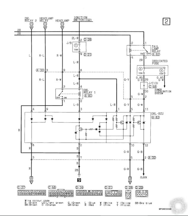

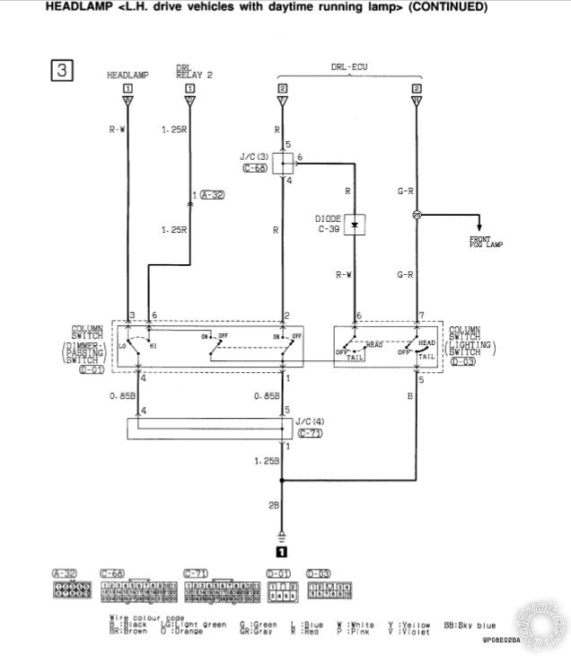

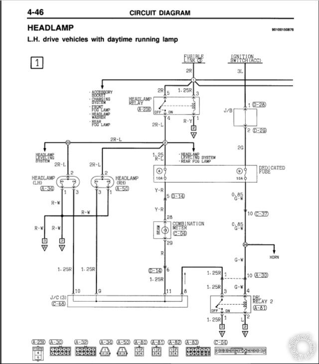

I have wired many cars, trucks and suvs With extra high beam spotlights, but I can't for the life of my get it to work on my montero sport. I have used a relay, wired it to be activated by the high beam signal from the front head light. Nothing happens. All the other cars I earlier have wired have been positiv switching headlights, and the montero must be negative switching, that's the only reason I can think of.....
Can somebody tell me how to wire this to work? ;)

Does the 'beam' indicator in the combination meter/instrument cluster
only illuminate when the high beams are on? A relay coil in parallel with the indicator should give the desired switching (yellow/red and red wires). A switch in series with the relay coil would allow disabling the spotlights. The relay should also be able to be wired across the RED / yellow and red at either headlight, as all these circuits are in parallel.

Sorry about wire colors and location......got caught up in the Dodge thing. It appears, by your schematic, that your headlights are negatively triggered as well. I hope my post helps.
