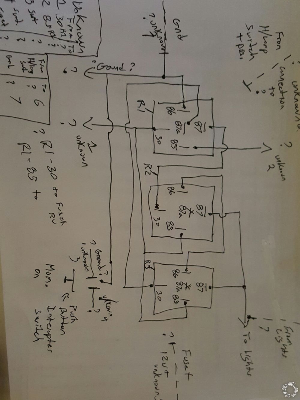

Posted: January 23, 2017 at 2:18 PM / IP Logged Link to Post Post Reply Quote rnewman81
Marker Lamp Interupter Switch - Last Post -- posted image.
Here is pic of what i got can you help cuz diagram you sent me has 4 relays i only had three.

Posted: January 23, 2017 at 2:47 PM / IP Logged Link to Post Post Reply Quote the12volt
I just looked over your diagram after saving it and rotating it. The way the coils of relay 2 and relay 3 are wired, I just don't see it doing anything.
My diagrams show 4 relays with a momentary switch that makes continuity when pressed and work as described. If I find the time, I'll attempt to accomplish the same thing with 3 relays and a different push button switch that interrupts continuity to ground rather than making continuity to ground.
