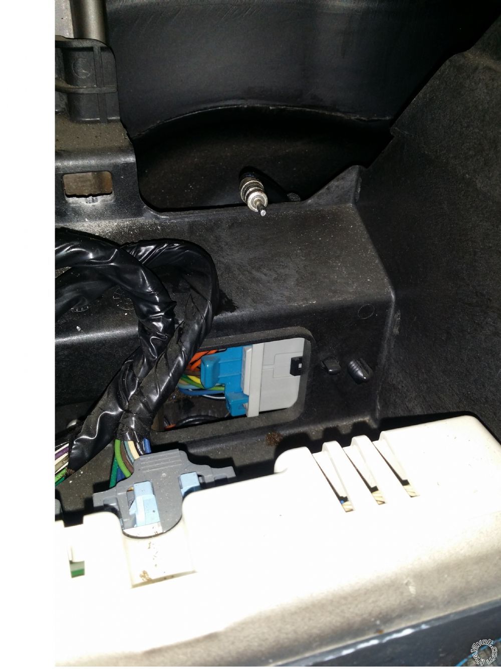

Posted: April 15, 2017 at 2:57 PM / IP Logged Link to Post Post Reply Quote i am an idiot
bypass gm bose amp - Last Post -- posted image.
Above picture is of an 04 yukon or tahoe with bose. For reference the air conditioner control is mounted.   The plug in the picture is attached to the 4 speakers of the vehicle. If there is a harness attached to your aftermarket radio, simply plug the pictured harness into the harness. No need to change anything. That harness has Constant, ground and data.
