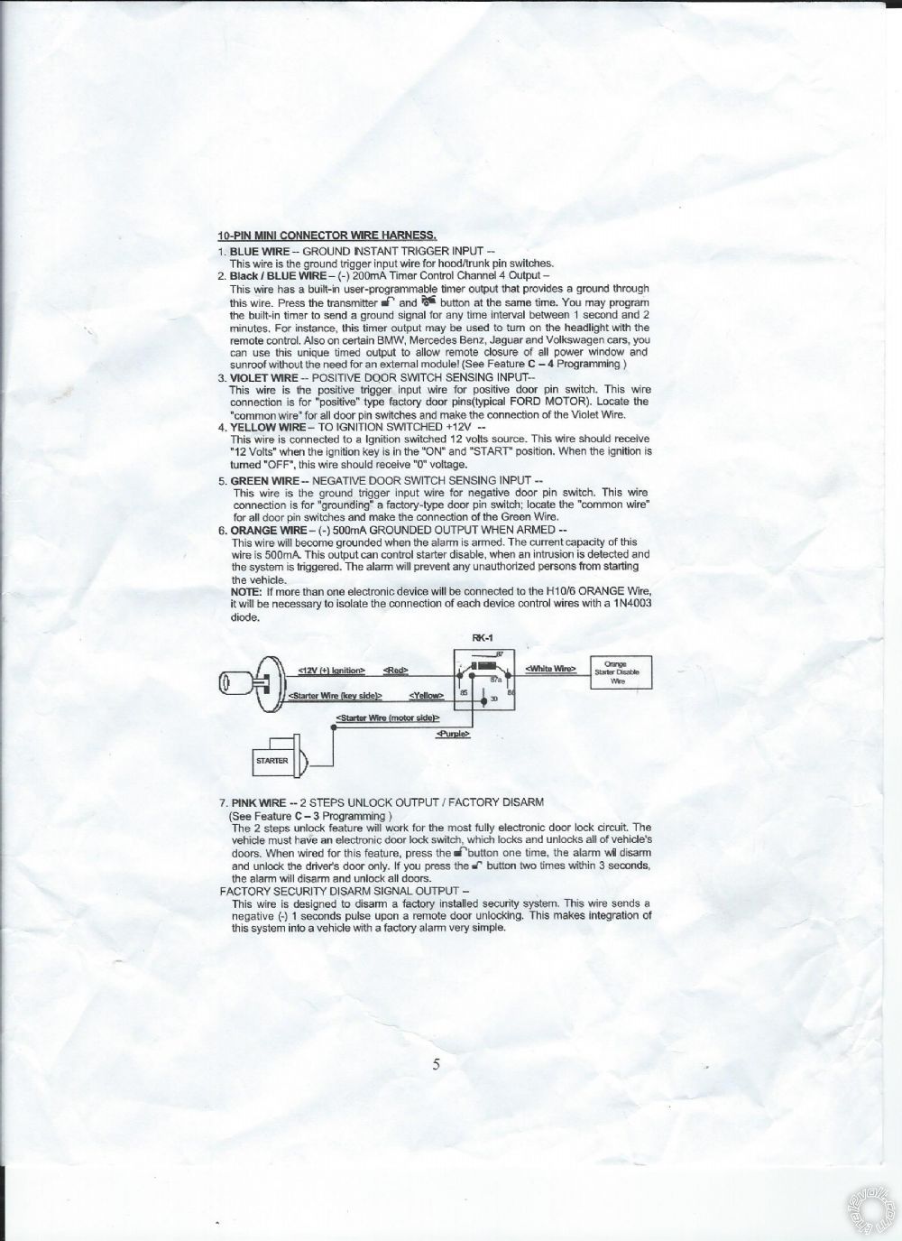

In this image autopage has an "orange wire negative when armed" to energize the coil in the relay.(86) Then they have 12 volts from ignition key. They put the starter or {mopar starter relay in my case} on the (87a) and then the key "yellow" wire on the (30) terminal. When "armed" it is supposed to disable the key's connection to the relay starter motor. This is just plain stupid cause when the coil is energized it will connect terminal (30) to (87a).Turning the key while its armed is only going to connect the starter to the key. The whole point is to disconnect the starter when armed if you turn the key.Useless instructions.
Nothing is "disabled".
