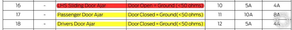

There is an output from Transit for the cab doors at the "High Specification Vehicle Interface Connector"
behind the glove box. pin
Switching Relay With Open Signal - Last Post -- posted image.
on pin 17 for Passenger door ajar (door closed=ground)
on pin 18 for driver door ajar (door closed=ground)
I need a ground when door open not when closed any ideas?
