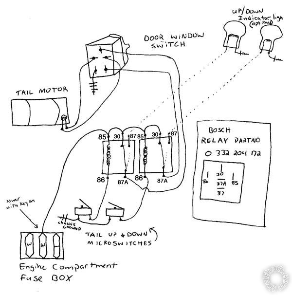

here my problem i have a spoiler on my porshe 991 who is only active on the demand of the car.
i got a diagram here to have it condroled by a window switch:
Active Wing - Last Post -- posted image.
the question is : how can i make this spoiler go up with the positive of my brake light then go down itself when i let go off the brake.
the purpose of all this drama is to upgrade to a bigger spoiler and use it for that we call "air brake" on race track...
how i made it clear and not too noob for you my friend !!
i cant wait for your reply ! thx !

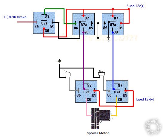

hi 12volt community i did my homework and draw this with the help of my first diagram and some 12volt relay diagram
what you think :
thx in advance.. Active Wing - Last Post -- posted image.

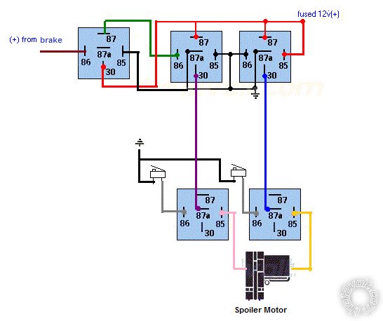

well.... 2.0 version ... -_-
This would be a lot cleaner if the circuit was redesigned using an H-bridge.
That would get rid of all those relays.
Any idea how much the motor draws?
