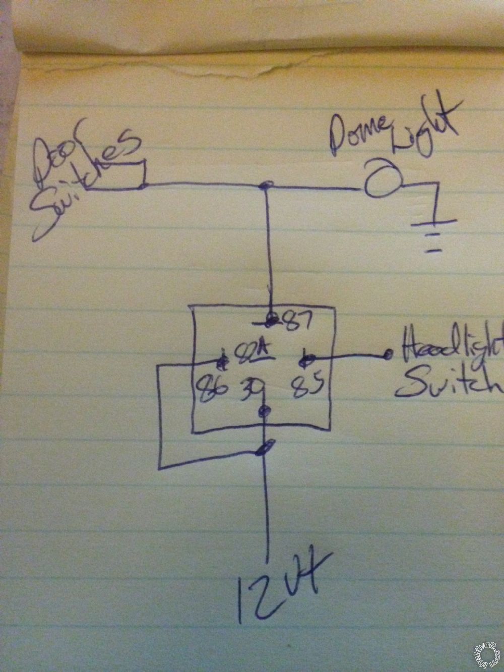

Posted: July 10, 2018 at 8:40 PM / IP Logged
53 Ford F-100 Dome Light Circuit - Last Post -- posted image.
this work ???

Posted: July 10, 2018 at 8:54 PM / IP Logged
No. The door switches should supply 12V+ directly to the dome light. The relay is needed only for the headlight switch to turn on the dome light.
