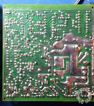

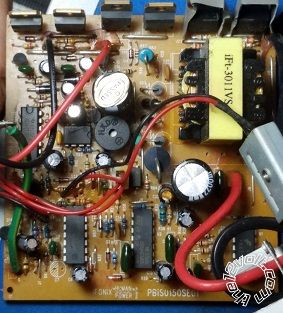

my friend told me to open it up and look at the circuit board for any burnt spots or anything else funny,   so i slid the circuit board out of it and i did'nt see anything bad on it, but i am posting pics of it here so you can see it.
Power Inverter Stopped Working? - Last Post -- posted image.
just wanted to make a post here to see if people can tell me if the power inverter i have is rated good enough where it should be able to work to power the soldering iron i have or if it caused damage to it when i was trying to use it with it ?        and also what to check or look for to possibly try to fix it or if i should just throw it in the trash ?        any help would be appreciated,    thanks

why does the large capacitor in the upper middle of the picture have that funky, screwed-up, shrink wrap appearance compared to the normal large capacitor a little lower in the picture??.. looks overheated or mis-manufactured and probably lucky it lasted this long if it ever worked [ and of course you said it did work,...for a while.. LOL
your 'friend' that sold it probably smelled something when he used it last time at nearly its full rated wattage
good luck my good friend

i really don't know why that capacitor looks like it does compared to the lower one ?,     but i know that it says to check things such as bulging looking capacitors that look like they are fat or about to burst, and that those are usually bad capacitors,   but i did'nt realise that one when i was looking at it last,   thanks for pointing that out,    i was trying to find another picture i had that shows it at a better angle to really see it up close to compare it to the other one but i could'nt find the pic, i kind of gave up on trying to diagnose or fix the invertor since its kind of cheap low-end one thats had fair amount of use, and put it away, thinking its not worth getting all into it so deep.
