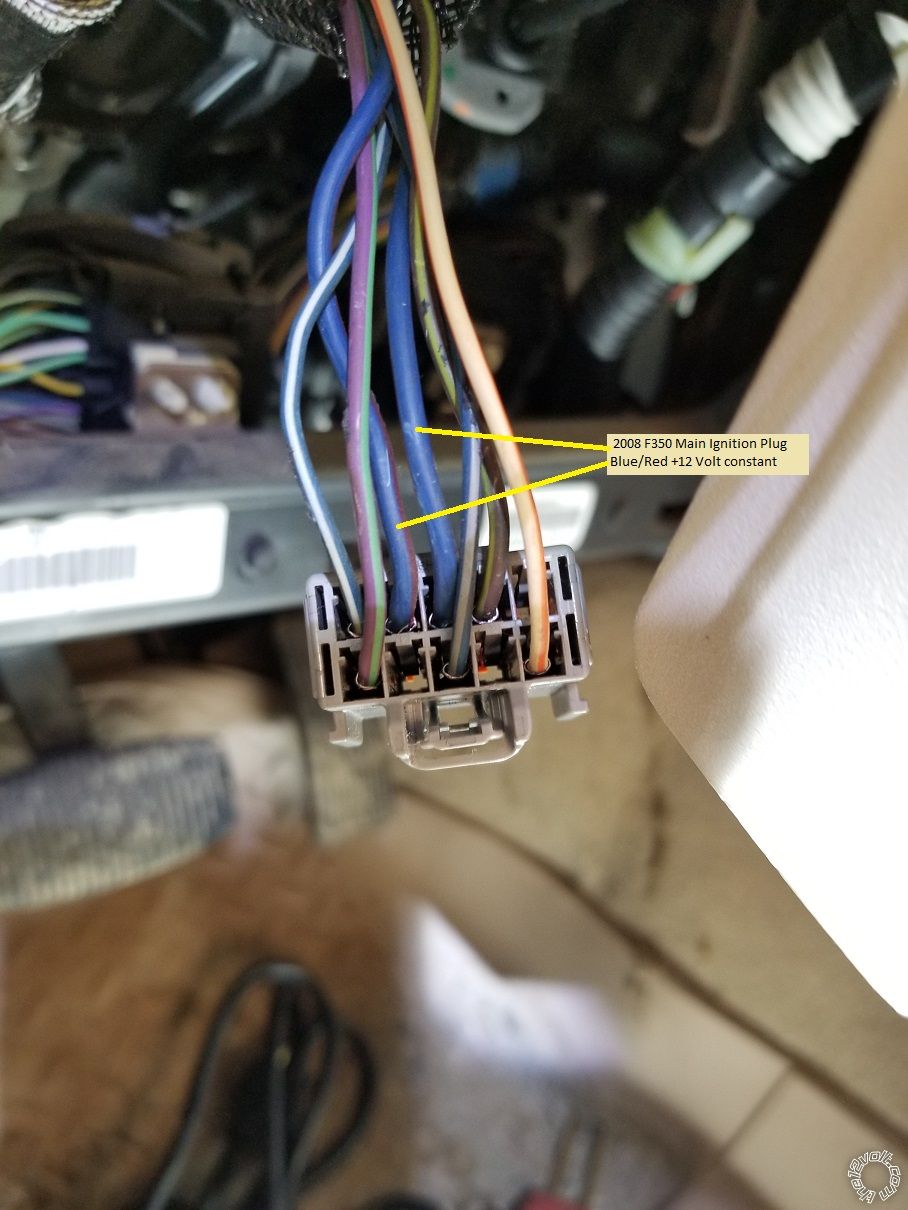

Which Compustar unit? If it's just a R/S system without an alarm, why not make your connections at the main ignition switch plug? There are two Blue/Red wires that are both +12V constant. Photo below :
Wiring Gauge, Compustar Remote Starter  - Last Post -- posted image.
They should be able to supply adequate power for the system. I just did a 2008 F350 diesel last week using those wires for power on a CS800-s unit.

You should be fine using those wires at the ignition switch harness. I didn't connect to the Keysense wire but did power both ACC wires. I also used the (+) Parking Light wire. I have more pictures if you need them.

Posted: February 02, 2019 at 6:56 PM / IP Logged Link to Post Post Reply Quote mbaker1082
Thank you for the picture that will help me a lot! I already have the unit installed but when I did it I used some heavy gauge wire to hook to the battery for testing to make sure it worked fused of course! I will get those constant wires moved tonight. I actually got very lucky with this truck. It is an xlt model but it was special ordered as a fleet vehicle so it was ordered with no factory security system and no keyless entry. I have no roof clearance lights so I was able to tie into that parking light feed in the drivers kick panel area to hook up my parking lights.
