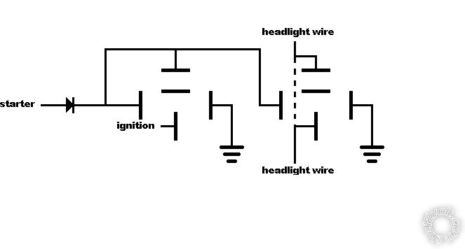

A couple options would be using an output that's only active while the engine is running (check for a wire at the alternator or the oil pressure switch) to interrupt the headlight wire(s) via a relay. You'd have to do some testing, and may need resistors and transistors for this.
Alternatively, you could use the starter wire to latch power to an interrupt relay:

You're right, no remote start. And the problem IS with the aftermarket HIDs. But, customers have come to me and I'm hoping to provide a solution for them.
As I'm typing this, I'm going through a dozen other tabs in Chrome. Email is one of them. One of the customers found a time delay relay on Amazon (yeah, most likely cheap stuff) but he suggests we can try that. So I've ordered it. I'll probably tie it in right after the light sensor. While the lamps can come on while the vehicle is off if someone just turns the key to run, I'll set it for a 10 or 15 second delay. The car should be running and no spikes or drops in voltage. I'm pretty sure that they lamps aren't igniting because of starting with low voltage. The relay is only $10 so it won't kill me if it's something else, and it's a lot easier than grabbing a wire from the alternator or oil pressure sensor (I was thinking of the oil sensor before I posted but if the car is on the pressure sensor is hot. And if someone had low pressure, their headlights would flash How To Keep Auto Lamps Off Until Engine Started? - Last Post -- posted image.
