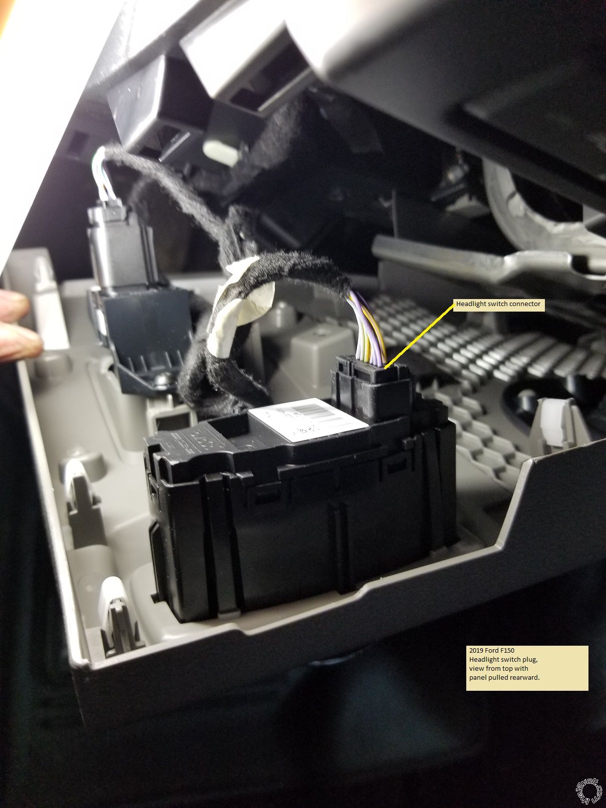

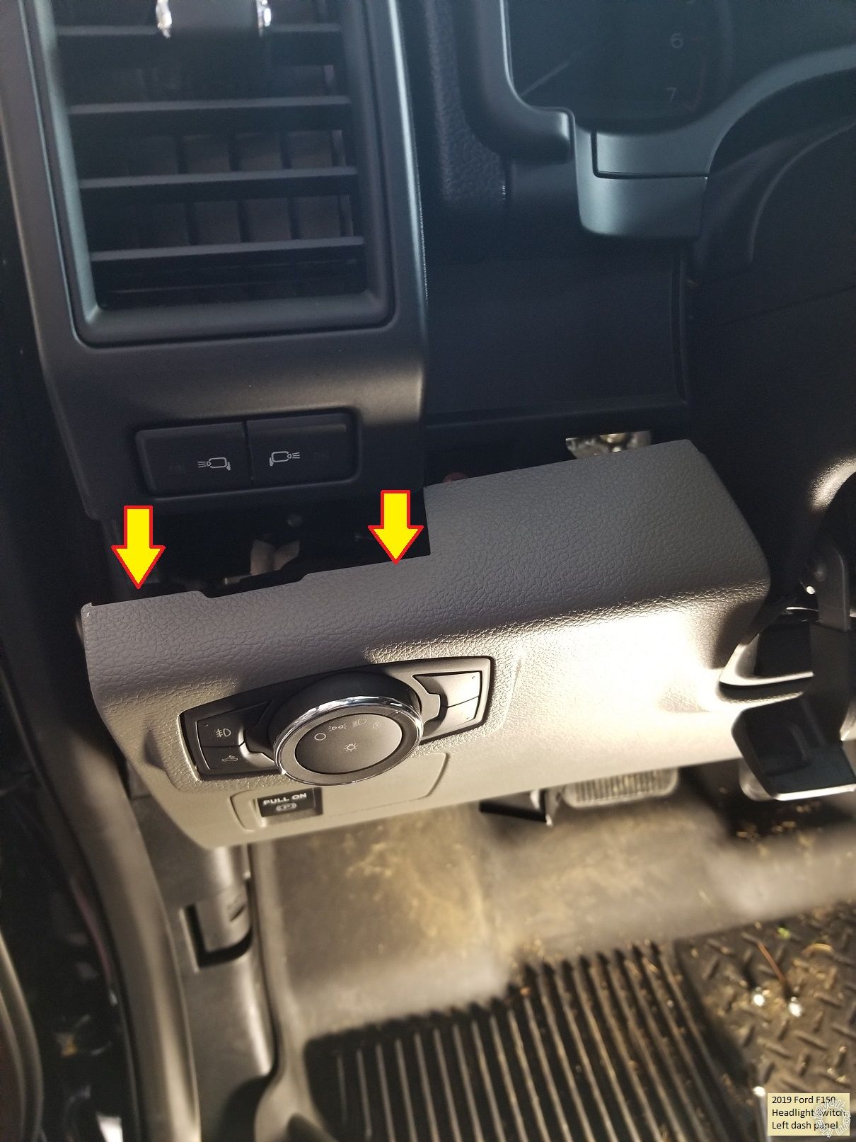

Not much needs to be done. Use the deep 8mm socket to remove the 2 nuts holding the OBD2
socket in place and gently pull in down for wire access. Remove the left side dash panel with
a non-marring trim tool then gently pull the lower dash panel back and away from the dash to
expose the back of the Headlight Switch assy. Release the Headlight Switch plug and remove
or roll back the harness wrap to expose the wires. That's it. Photo's below :

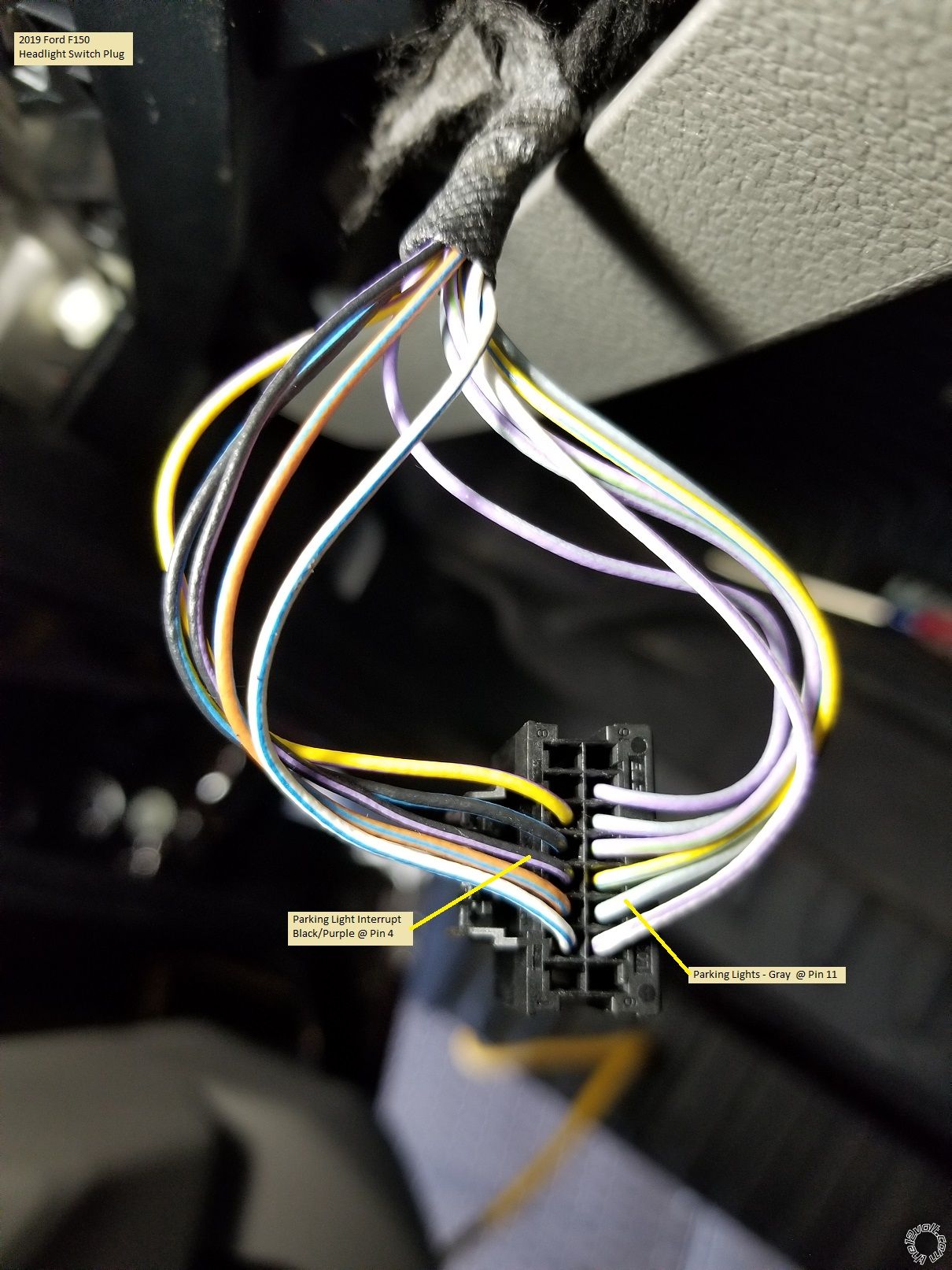

This photo shows the back of the Headlight Switch and the necessary wires :
2015-2019 Ford F-150 Stand Alone Remote Start Pictorial - Last Post -- posted image.

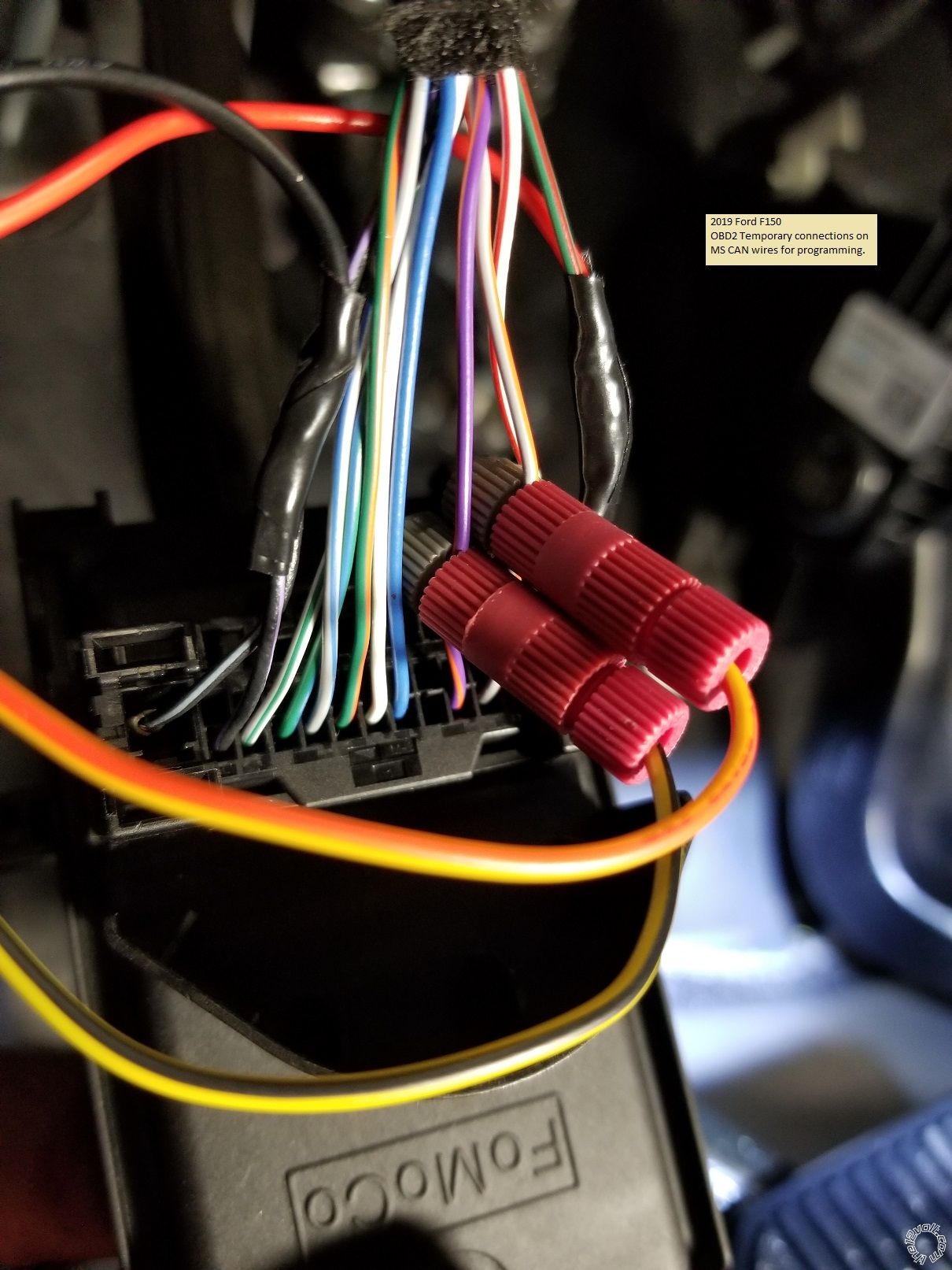

With the single CAN ADS AL-CA, you must make temporary connections to the MS CAN
wires during programming. This can be accomplished by using Posi-Taps as shown below :
While they are not cheap, they will provide an easy way to accomplish the dual CAN programming
and not harm the vehicle wires. Posi-Tap PTA-1800M is shown in the photo and will work with
18 to 24 gauge wires. While you might be tempted to use these taps on all your connections,
I would still recommend a nice solder joint for long term reliability.

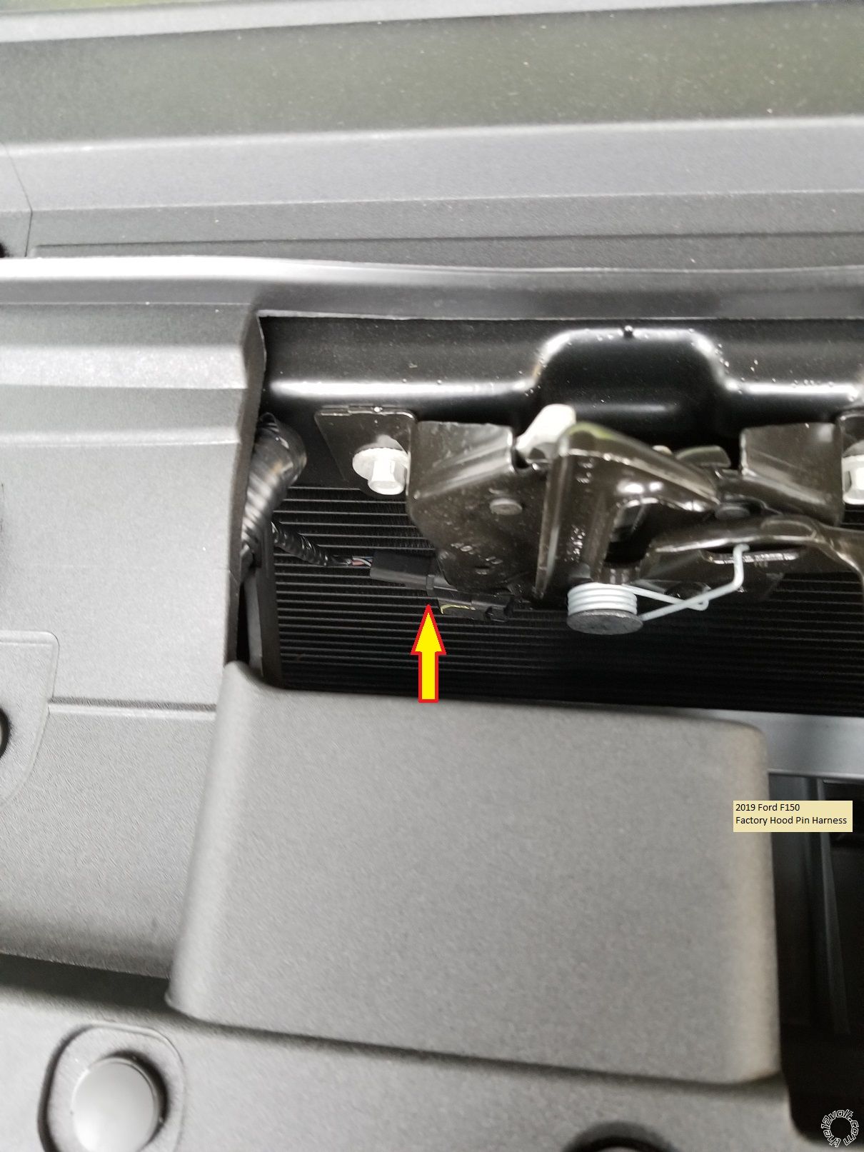

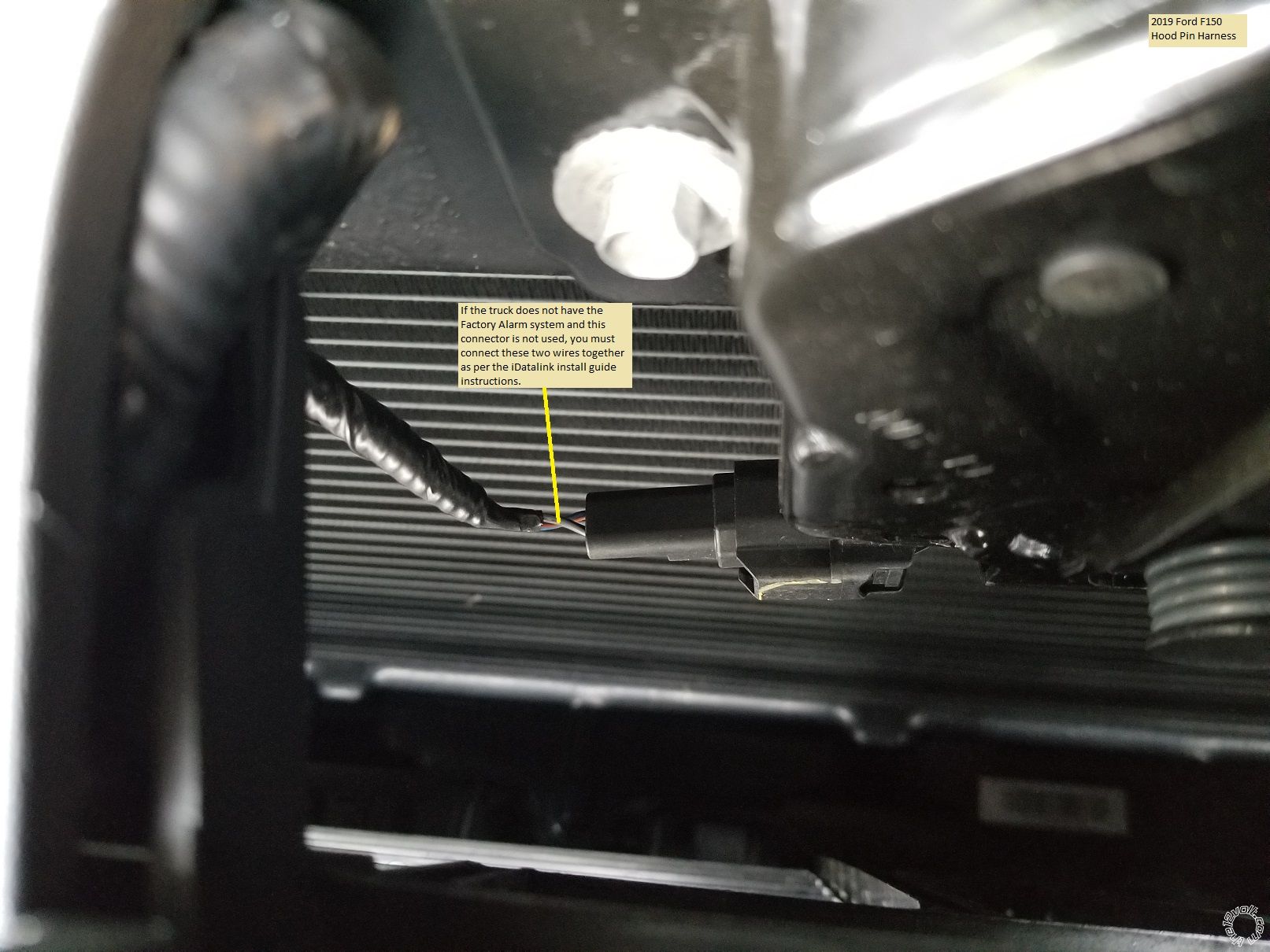

As mentioned above, if your truck does not have a Factory Hood Pin you must add a
jumper between the two wires in the vehicles unused hood pin harness. The photos below
show the location of the harness and the two wires ( in a truck with a hood pin ).

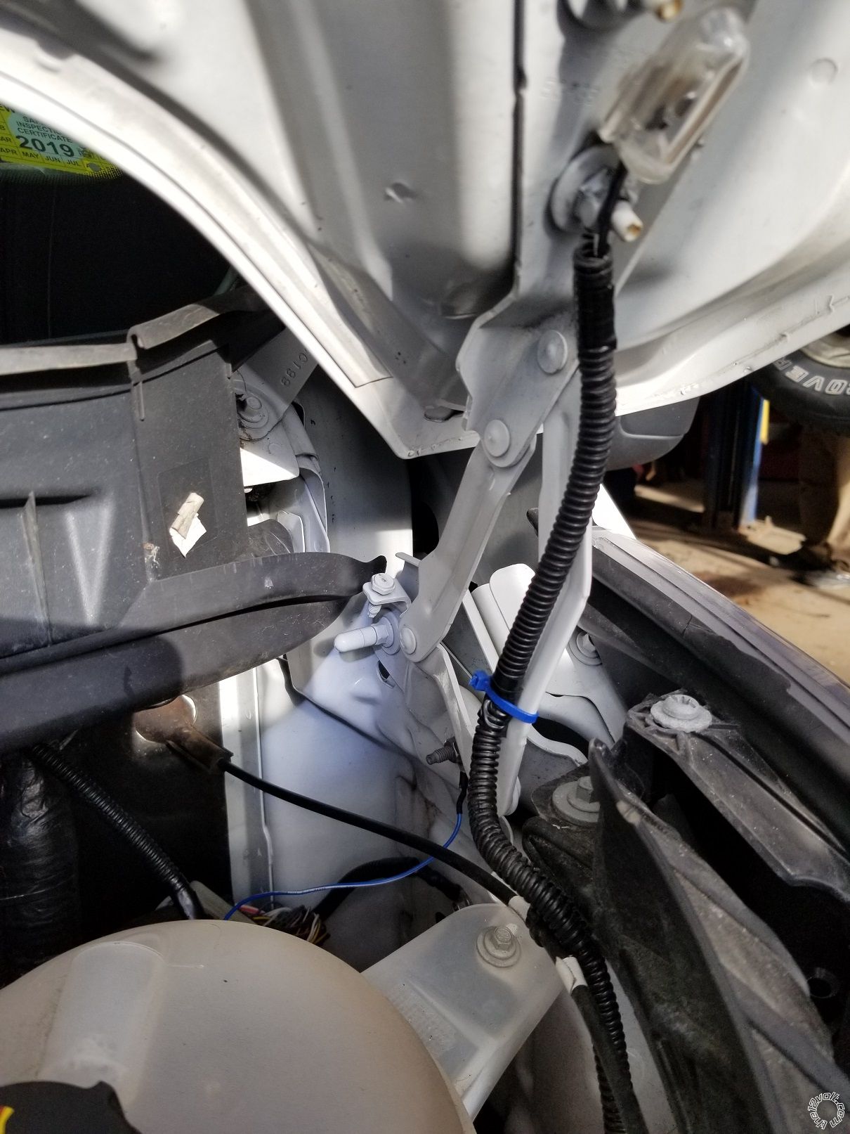

Using a mercury tilt switch attached to the hood hinge is a reliable rust-free way to add
the safety of a hood pin if your truck does not have a hood pin.
Shown above is an Omega AU46 mercury tilt switch.
