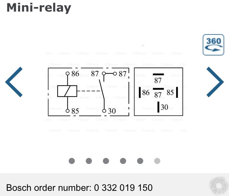

I have added power door locks to my 67 Chevy c10 and integrated them with my alarm. However, when I wire up the relay (following the wiring diagram on the site for door actuators without a switch) the fuse blows instantly when I connect the power. Now I am assuming its grounding out, but I am not sure why. I am using 2 Bosch 0 332 019 150 30Amp relays...not sure if there are maybe different types with different pin setups? I do notice these relays dont have an 87a..just 2 87's. But that's the only difference. Any help would be awesome Relay Diagram

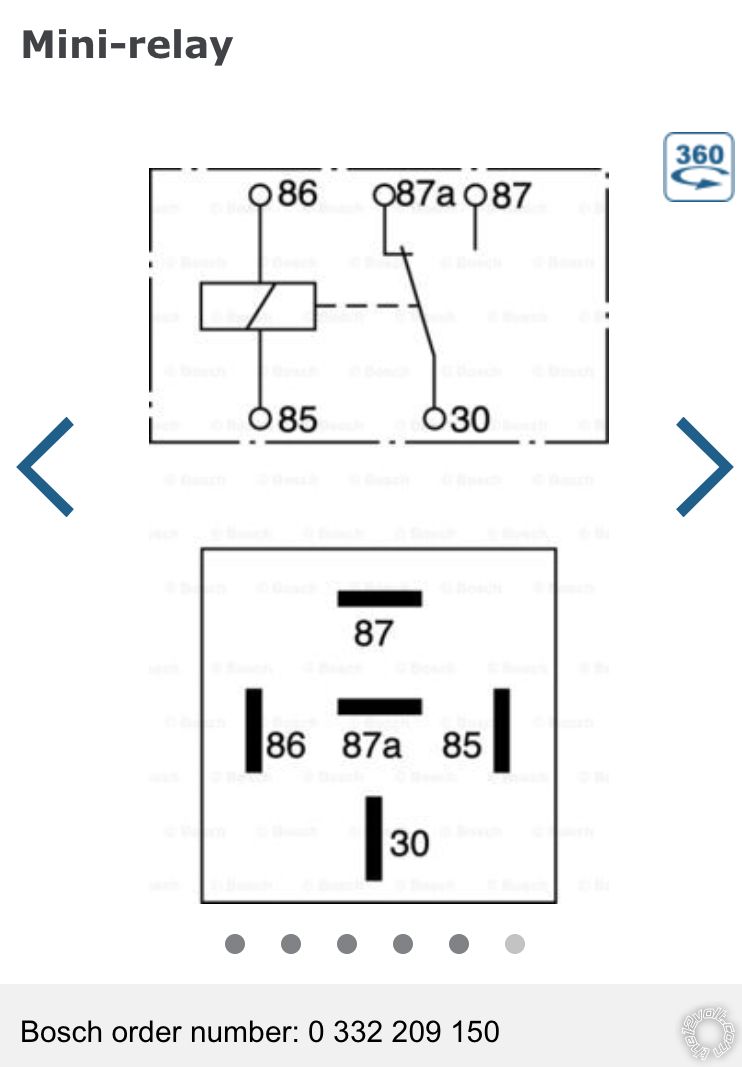

I took a closer look at the relay that you listed. It turns out that it does have 5 terminals but it’s not a typical relay that we use. You ended up with a special application relay that happens to have the same look as the correct one but isn’t what you want. I assumed when you said there was no pin 87A that you had a 4 pin relay. Yours actually has 2 pin 87’s that are internally connected all the time. That is what is causing your short. Relay for Door Actuators Blowing Fuse Instantly - Last Post -- posted image.
The ones we typically use have 1 pin 87 and 1 pin 87A that are never connected internally. A better Bosch alternative that would suit your purpose is part 0-332-209-150 that I linked below and looks like this internally. Bosch 0332209150
