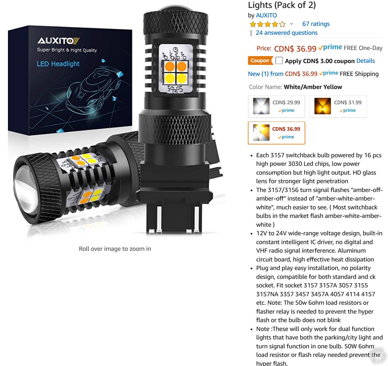

The easiest would be to just get something like this which does what you need without external circuitry.
https://www.amazon.ca/AUXITO-Extremely-Chipsets-Switchback-Projector/dp/B0756B3T1D/ref=sr_1_5?crid=203LJ6VJN8HPO&keywords=3157+switchback+led&qid=1569162195&sprefix=3157+%2Caps%2C391&sr=8-5

Posted: October 16, 2019 at 8:00 AM / IP Logged Link to Post Post Reply Quote eguru
novanutcase wrote:
Link doesn't work.
John
Here is a screenshot of a product that simplify your installation issue.
LED Turn Signal Polarity Switch - Last Post -- posted image.
