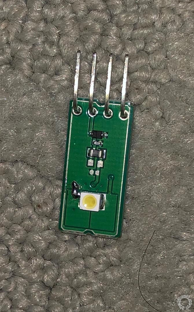

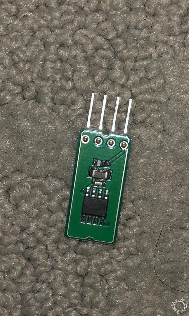

Hi guys... I'm trying to add some ambient lighting to my Audi 8V, I'm using OEM VW SMDs for the purpose and running the wires as illustrated in the picture. It's hooked up to an ambient light wire and ground, but it created some EMI/RFI interference with the keyfob, I literally have to stand within inches to the car before I could lock and unlock the door, it doesn't really matter if I hook them up with other wires or ground, still the same result, but if I hook them up to external power than it's all fine so I guess the SMD isn't the fault here and it's the wires or the length of the wires? I've since added 4 small ferrite beads to the wires, it helped a little but still working very intermediate.. Can someone please help and see what else can be done to fix this? Thanks!!

It was worth trying. If you power the SMD's externally and have no noise, that tells me they are not the source of noise.
