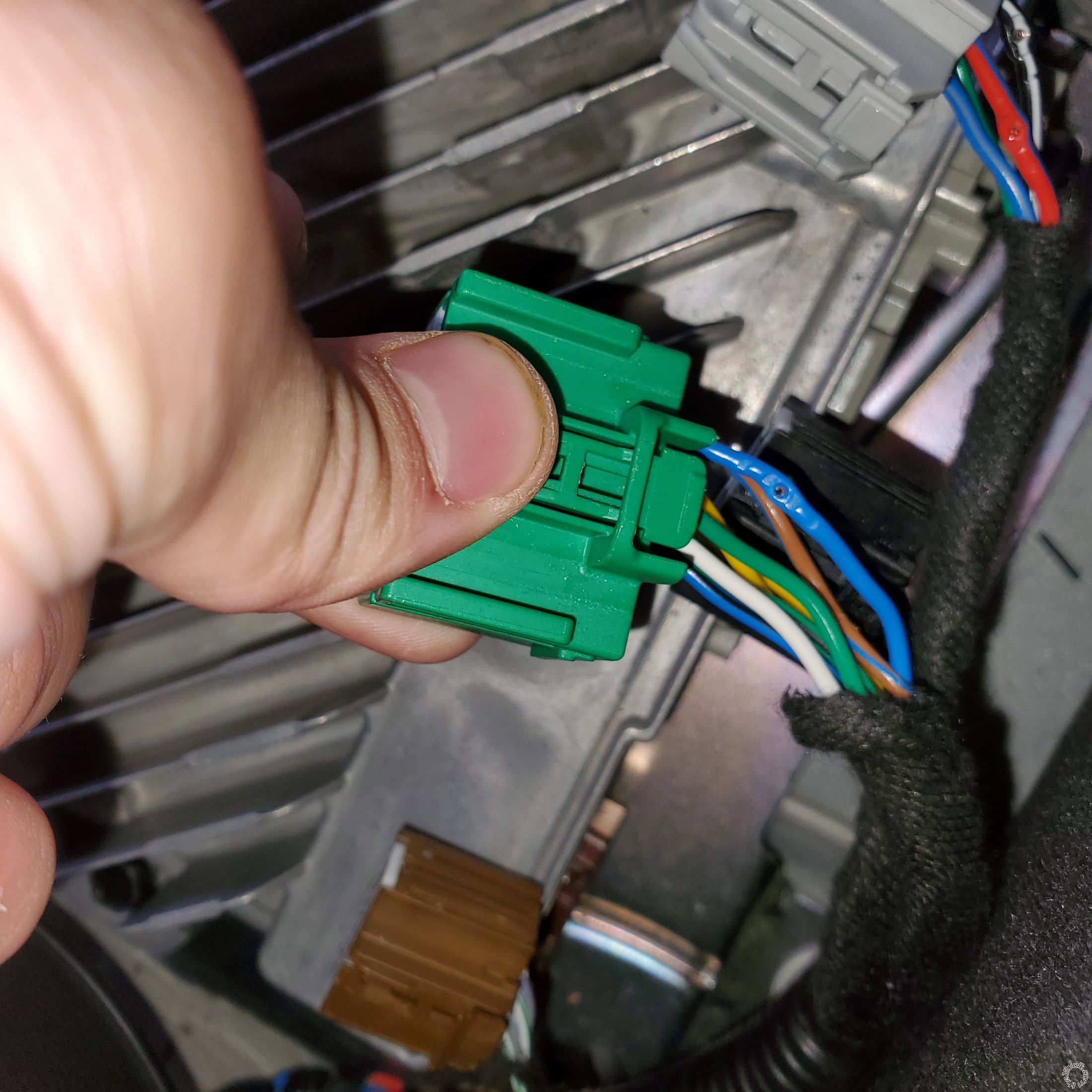

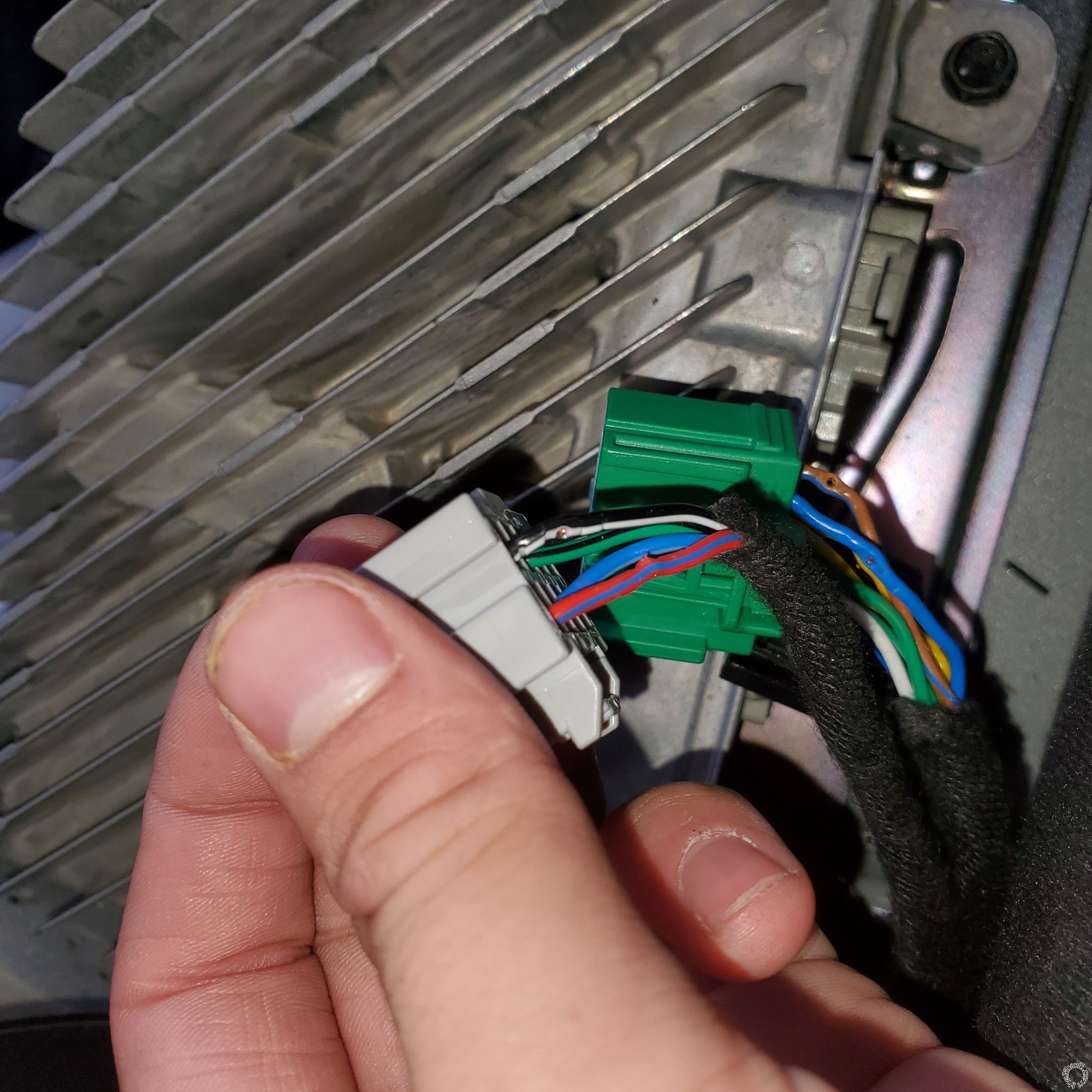

Left Front Speaker (+/-)      Blue - Brown/Blue      +,-      Amplifier near rear wheel well, green 16 pin plug, pins 7 - 15
Right Front Speaker (+/-)      Yellow - Yellow/Black      +,-      Amplifier near rear wheel well, green 16 pin plug, pins 6 - 14
Left Rear Speaker (+/-)      Green - Green/Black      +,-      Amplifier near rear wheel well, green 16 pin plug, pins 5 - 13
Right Rear Speaker (+/-)      White - Blue/Black      +,-      Amplifier near rear wheel well, green 16 pin plug, pins 4 - 12

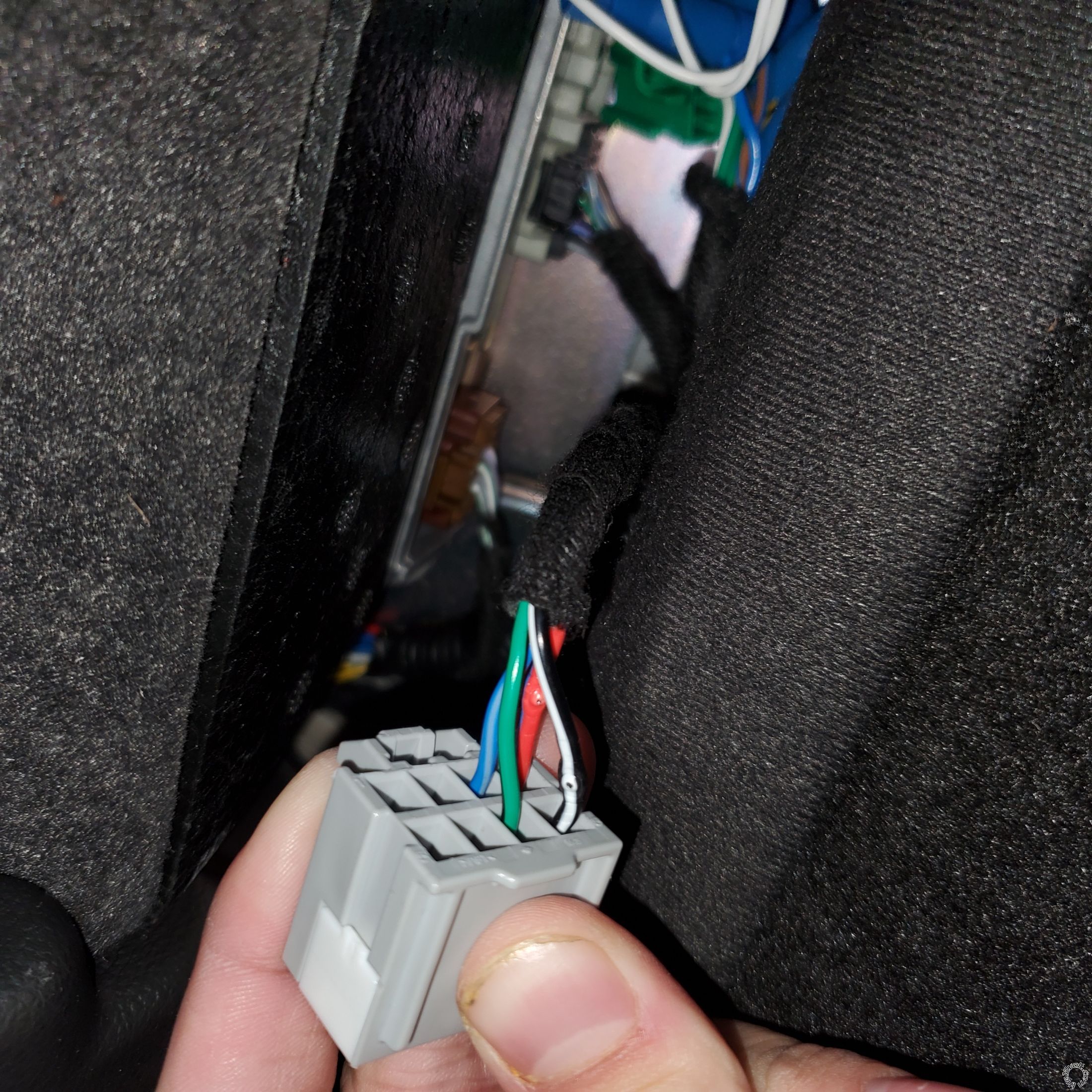

Subwoofer (+/-)      Green/Black - Blue/Gray      +,-      Amplifier near rear wheel well, gray 8 pin plug, pins 7 - 3

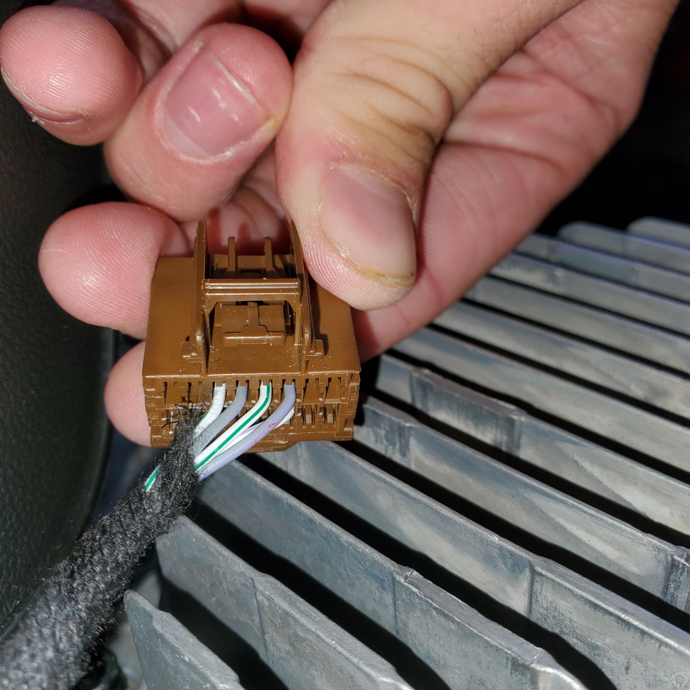

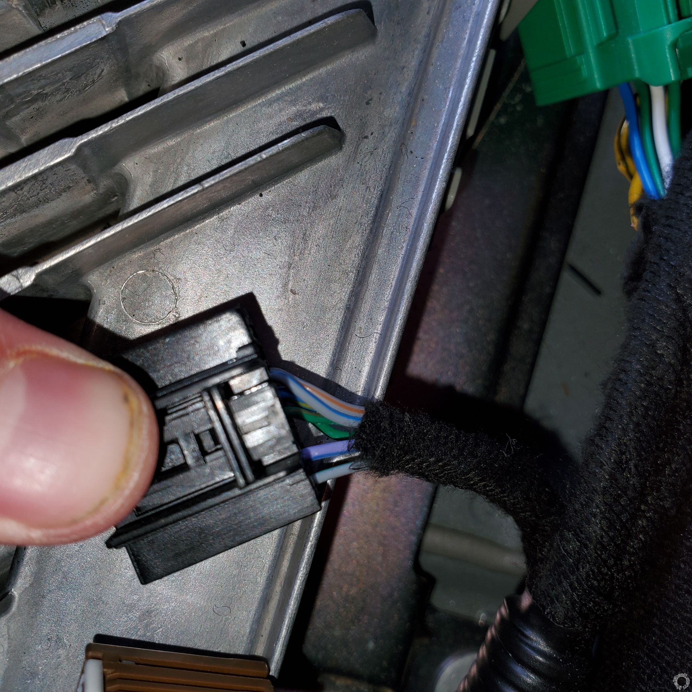

Thanks this highlighted an error I made, for a system like this I have to disable the Bose noise cancelling do you happen to have access to what wires these are so I can cut them? I belive it is two if i remember right.
Platinum - Posts: 13,726
Posted: November 06, 2019 at 5:12 AM / IP Logged Link to Post Post Reply Quote i am an idiot
Post a picture of the plugs. I do not know the wire color but will be able to point it out.
