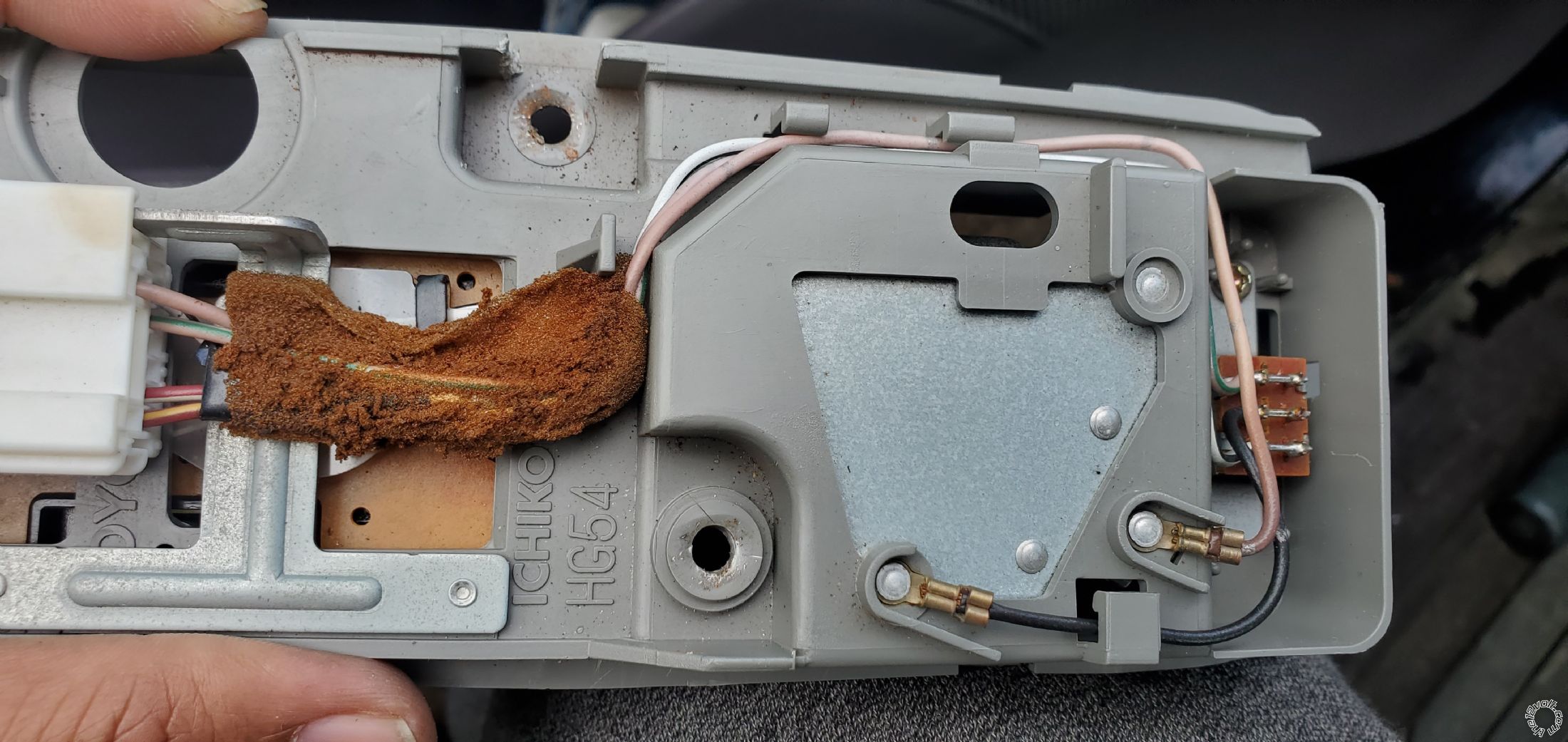

Dome Trigger for LED and Relay, 2000 Toyota Celica GTS - Last Post -- posted image.
4 wires to dome.
Red always live
Off dome pin:
Black is ground from trigger to bulb
Live wire middle and bot when lights on
Live wire door position bot right black/white. But door open all 3 live.
Live wire bottom right black/white when lights off
I use a multi meter says my car is negitve trigger. It also has dim i check when closing the door
