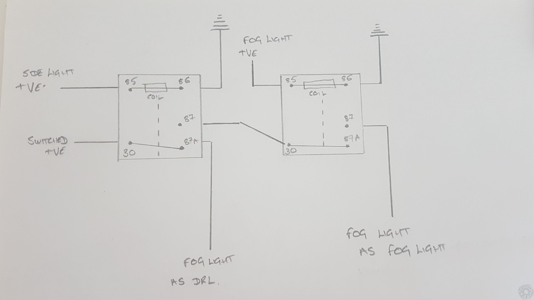

Hi guys, I want to use my existing fog lights as DRL's when side lights off, then to switch off and still be functional as fog lights when the side lights are activated. I believe I have the basics of the circuit completed in the attached document. However to complicate matters I would like to wire the fogs to blink in unison with the indicators, regardless of the side lights being on or off. Being in the UK I will be changing the lamps to yellow.
Any help or guidance appreciated.
Cheers
