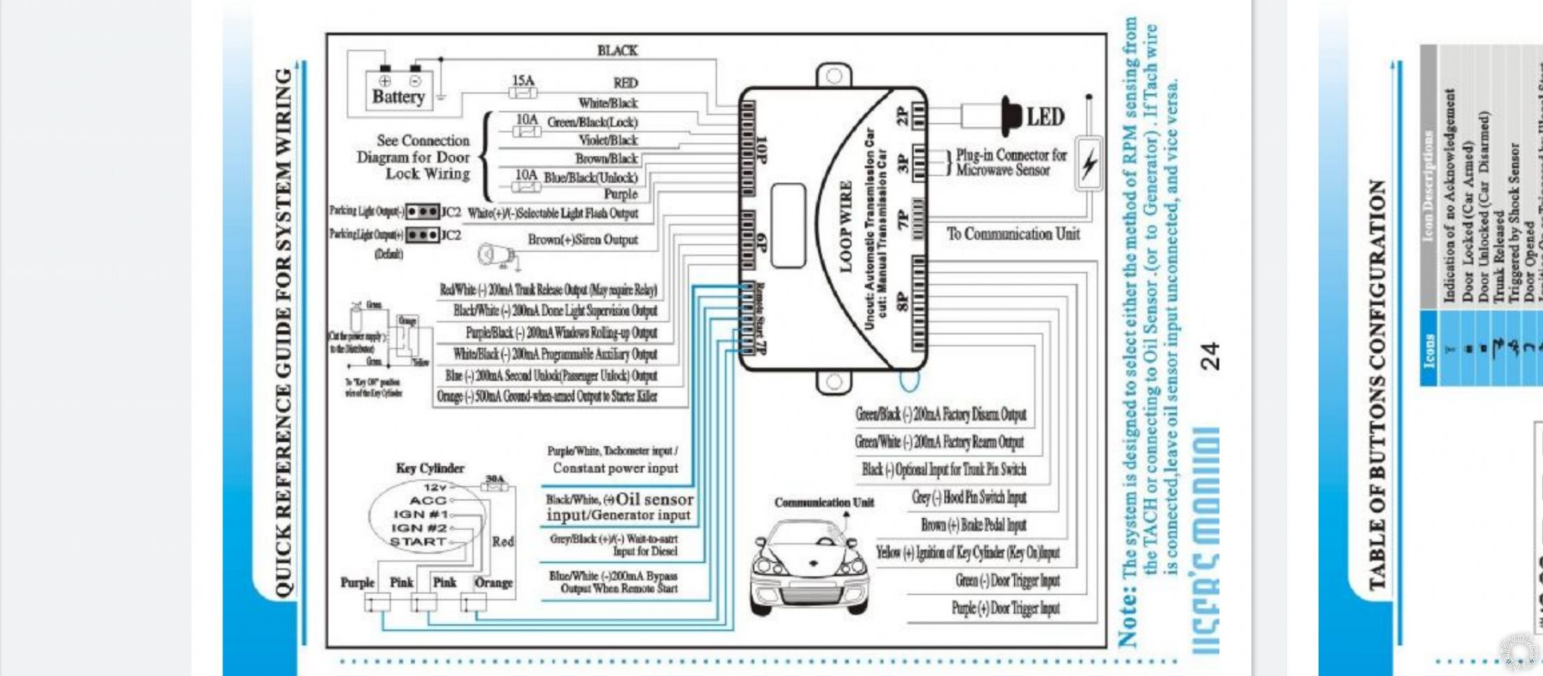

I have a 98 Volkswagen golf that I have removed the factory alarm out of and bridged pins 5 and 6 on the six pin connector this is working fine however I want to install an aftermarket alarm and remote start unit. I have looked at the wiring that was hooked onto the factory alarm and it has a lot of what my alarm needs to be installed right there. I was wondering if I will need to do as the aftermarket alarm says about the parking lights needing a relay and cutting the switch wires for the headlight and other things or can I just hook up the corresponding wires to the factory harness for the factory alarm?

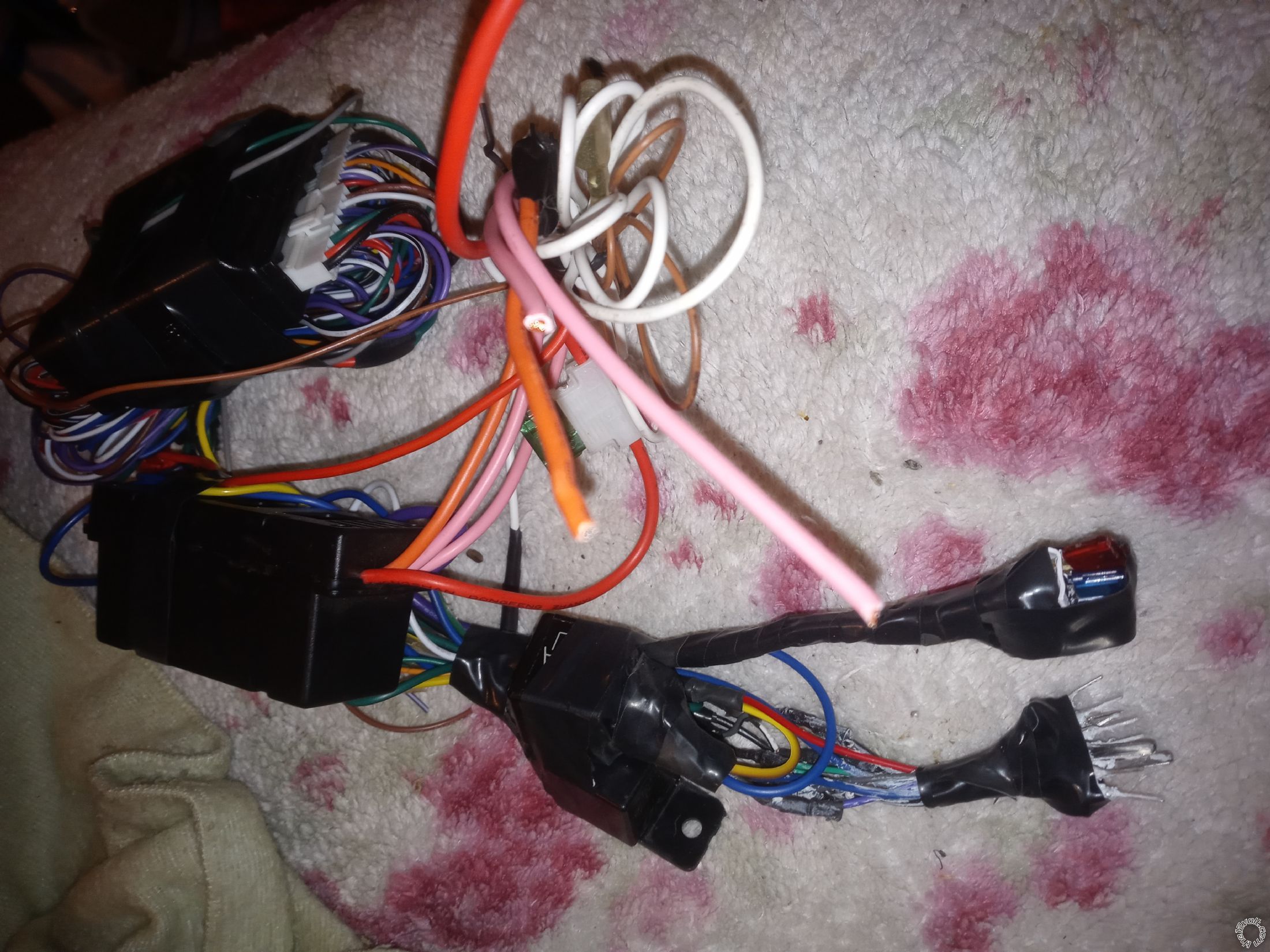

If all of that looks good, I made my own adapter plugs to just plug into the existing factory alarm harness and I just have to run my larger guage remote start wires and the siren and brake wire. Thoughts and ideas welcome.

Ok I think I got it all setup. I couldn't use my homemade plugs they looked like crap so I took them from the original alarm. But I was wondering if I can connect the remote start accessory wire with a diode to the clutch position switch for the remote start to bypass to clutch or will I need a relay?
