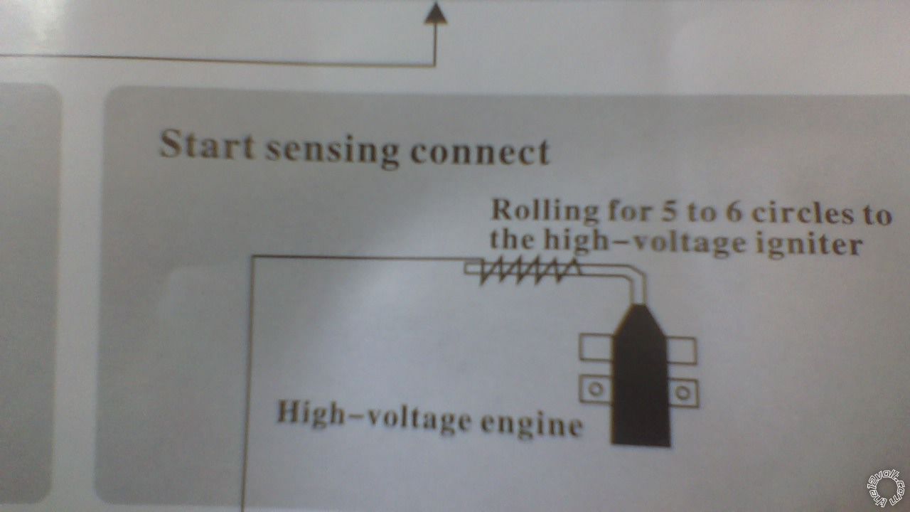

Also, I need some help with a few other issues I'm not understanding with the instructions that were sent with the system. The first is the system diagram shows a start sensing connection that I need to make. It looks like I need to wrap a wire around the high voltage igniter with the picture showing what appears to be a wire going to a coil. I'm unsure what I'm supposed to connect to. Can I just tap into the igniter circuit wire?

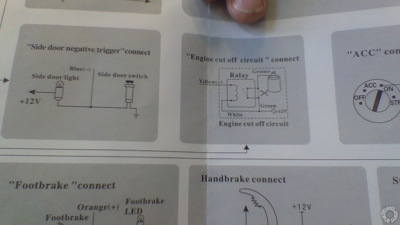

Another question I have is about the engine cut off circuit. I'm not sure which relay the connection is supposed to be made to and how the connection is supposed to be made.
2015 Toyota Tacoma, Stellar STRS9960 Alarm/Remote Start - Last Post -- posted image.
Any help is greatly appreciated, Thank you!!
