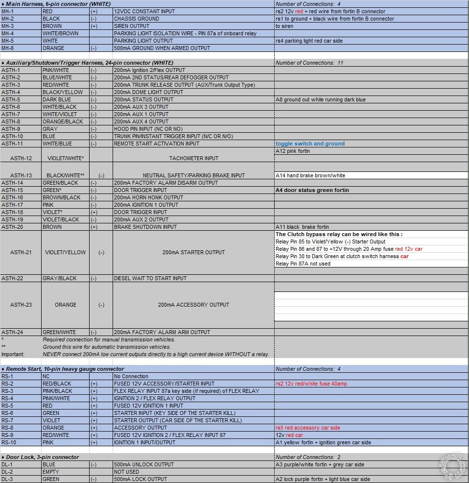

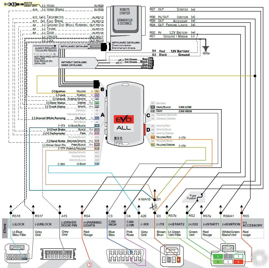

This is my kind of wiring diagram for my installation. what do you think? thank you sharing knowledge. appreciate it

Its absolutely meant to do that when its hooked up right. If you leave it in gear and RS it its gonna take off which is what no one wants. I am not really sold on doing RS on manual trans even with the safety features in place, I turned them away every time. Make sure tach is connected to a fuel injector, black/white neutral safety wire is hook to the cars neutral safety wire or e brake, and door status and you use the RS in manual transmission mode and do the sequence every time you get out of the truck. I don't know much about fortin and how reliable there outputs are on there bypass module over data so ay if it will be accurate every time
