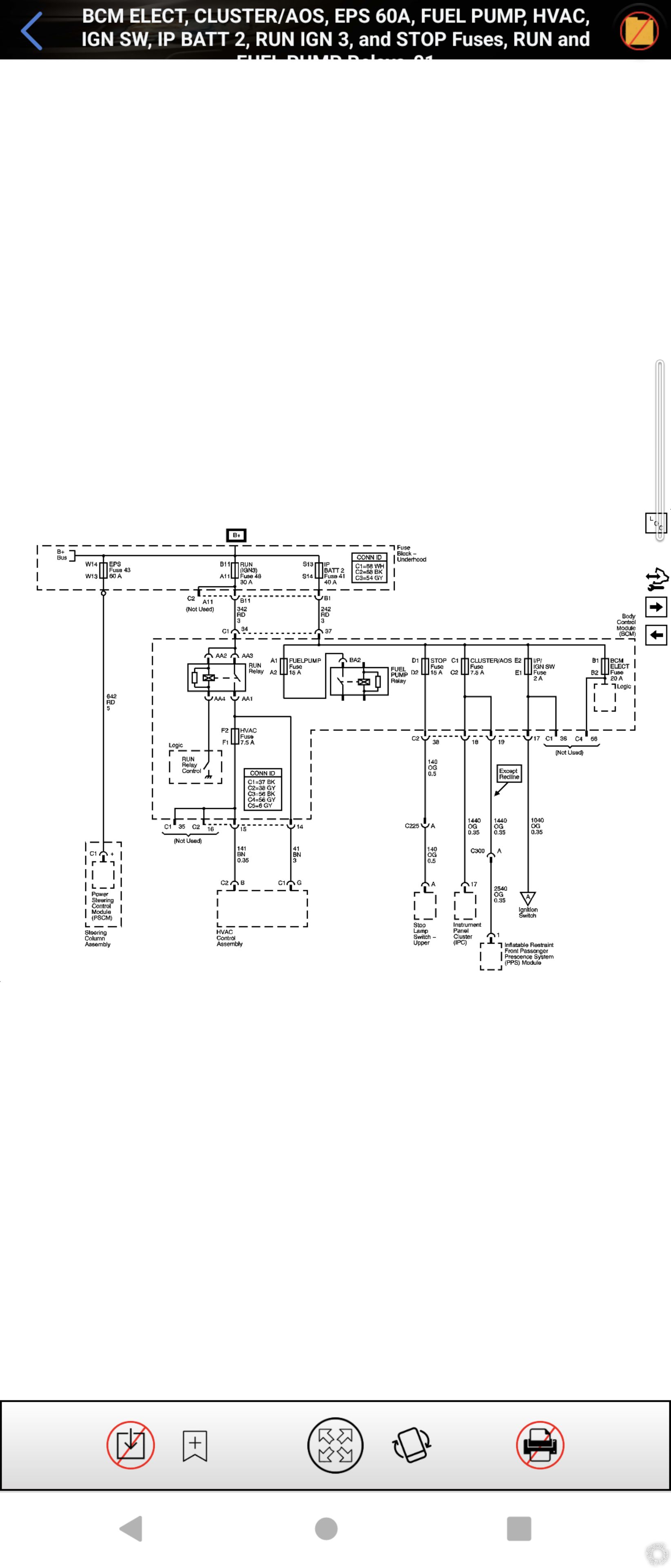

Posted: March 03, 2023 at 10:42 PM / IP Logged Link to Post Post Reply Quote miguelangelos
saturn ion 2006 the bcm connector c2 orange cables most of them are battery positive and it turns out that there is no power to any pin someone could help me solve that thanks

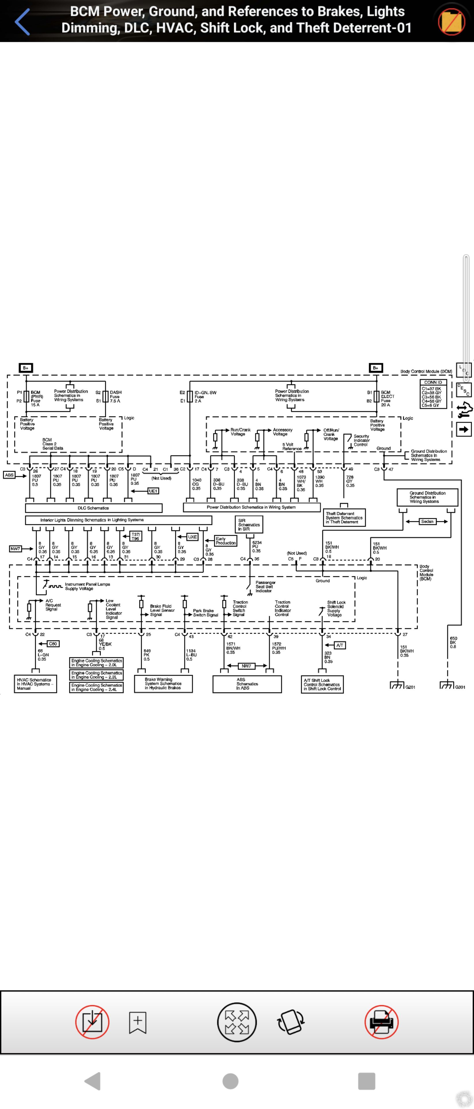

Posted: March 04, 2023 at 4:50 AM / IP Logged Link to Post Post Reply Quote geepherder
Check the 2 amp fuse at the BCM. 2006 Saturn Ion, Passlock 2 - Last Post -- posted image.

Posted: March 04, 2023 at 4:57 AM / IP Logged Link to Post Post Reply Quote miguelangelos
ok, check the 2 amp fuse, but if there is no power, what could it be? I think none of those pins of the gray C2 have power, I checked it with my test lamp and zero because of this I have been struggling a lot lately for my car to start no and succeeded

Posted: March 04, 2023 at 7:30 AM / IP Logged Link to Post Post Reply Quote geepherder
These all get power from the underhood fuse box fuse 41 (40 amp).
